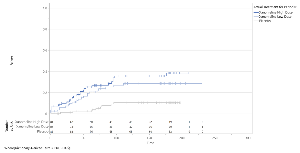

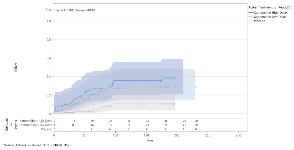

Figure 2 presents a failure plot version of the KM plot. The y-axis starts at 0, implying no patients start with pruritis TEAEs. By day 200, nearly 40%, 29%, and 11% of high dose, low dose, and placebo patients have had at least one pruritis event, respectively. The time at risk table (adjustable) communicates the number of patients still at risk for having a pruritis event or censoring outcome. The KM plot (Figure 3) can be modified by the user to include confidence intervals (pointwise and/or simultaneous), details on the outcome of the log-Rank and Wilcoxon tests, or to change the Number at Risk table to summarize Cumulative Events, the number of patients experiencing an event up to and including the summarized day (26, 21, and 8 patients for high dose, low dose, and placebo patients, respectively).
Figure 3. Kaplan-Meier plot of pruritis with intervals, tests, and cumulative eventsFigure 3. Kaplan-Meier plot of pruritis with intervals, tests, and cumulative events

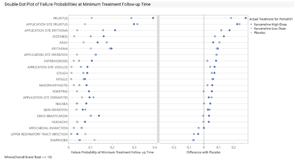

Of course, the big challenge is to screen across all events. A double-dot plot (Figure 4) of the cumulative proportions of events and the differences in those proportions as well as a max difference plot (Figure 5) are produced. The double-dot plot is produced at the minimum treatment follow-up time observed across all events so that a single time can be used to consistently compare all PTs. For this example, this follow-up time is 197 days, meaning that the cumulative proportions presented in Figure 4 are computed at that time, with pruritis showing the greatest differences with placebo. So why a double-dot plot and not the more traditional dot-forest plot that is computed for Adverse Events Risk Report or Adverse Events Recurrence? It’s due to how the confidence intervals (CIs) are produced for each KM curve, based on a transformation of the curve to ensure that the CIs are strictly non-negative (as proportions tend to be). There simply is not a straightforward computation to compute this interval based on the KM estimate, and rather than use these proportions in a CI formula based on normal approximations (which would not align with the KM plot), I left out CIs entirely in the right panel. What is presented are the estimates of the differences in cumulative probabilities between the active doses with placebo (the user may change the control group).

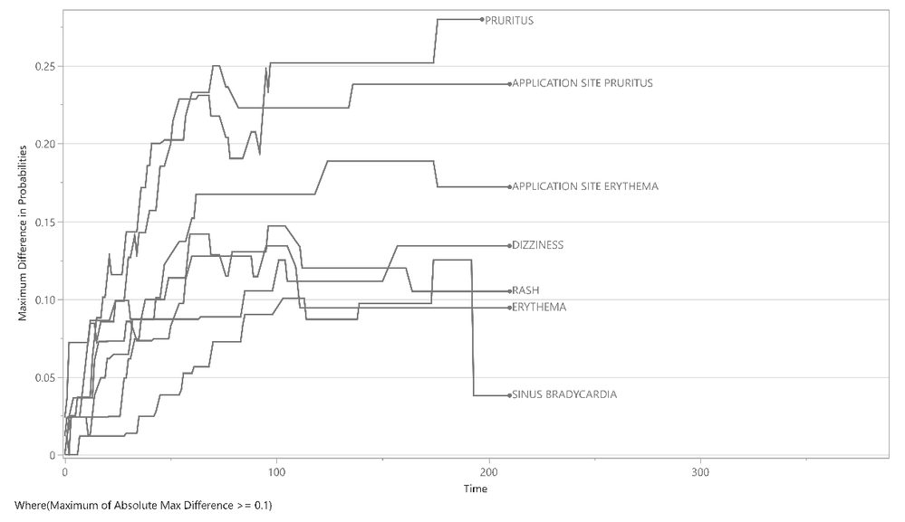

However, similar to the downsides in recurrence of using a single time point to determine the importance of an event, Figure 5 communicates the maximum difference in KM curves between the available treatments. The plot is subset to only include curves where the maximum difference between KM curves was at least 10% at least once. This limits the screening effort to seven different TEAEs, with pruritis showing the greatest risk over time (though application site pruritis also exhibits notable differences through the first 100 days, only losing to pruritis by the end).

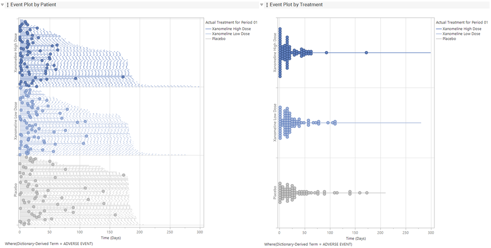

While analyzing individual events using PTs is useful, additional analyses can be performed to consider groups of events based on specific characteristics by using the Collapse Events option and the Adverse Events Filter. Clicking Collapse Events will produce a TTE analysis to the first TEAE of any kind (Figure 6). Given the large preponderance of dotted follow-up lines, most patients who experience their first AE tend to stay in the trial. The right panel shows that many AEs occur for high and low dose patients at the start of the trial, possibly signaling tolerability issues.
Figure 6. Event plots by patient and treatment for all TEAEsFigure 6. Event plots by patient and treatment for all TEAEs

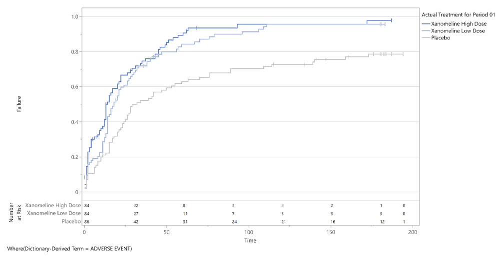

Figure 7 presents a KM plot of all TEAEs. By Day 60, 93%, 85%, and 62% of patients have experienced at least one TEAE. This grouped analysis is extremely informative, and can be applied to produce informative TTE analyses in other ways:

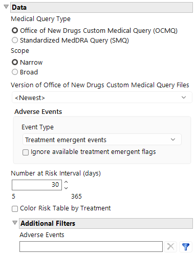

Medical queries (SMQs and OCMQs) are an additional type of “grouped events” that seeks to collapse the large number of preferred terms into a more manageable set of terms that represent medical concepts. As seen in Figures 4 and 5, for example, “pruritis” and “application site pruritis" are analyzed as separate events. Two other terms with “pruritis” exist among TEAEs, “eye pruritis” and “pruritis generalised” Medical queries (MQ) group related PTs into MQ terms. Analyses of TTE for MQs can be performed using Medical Query Time to Event (Figure 8). Users can specify the query type, version, scope, and the PTs to consider when producing the analysis.

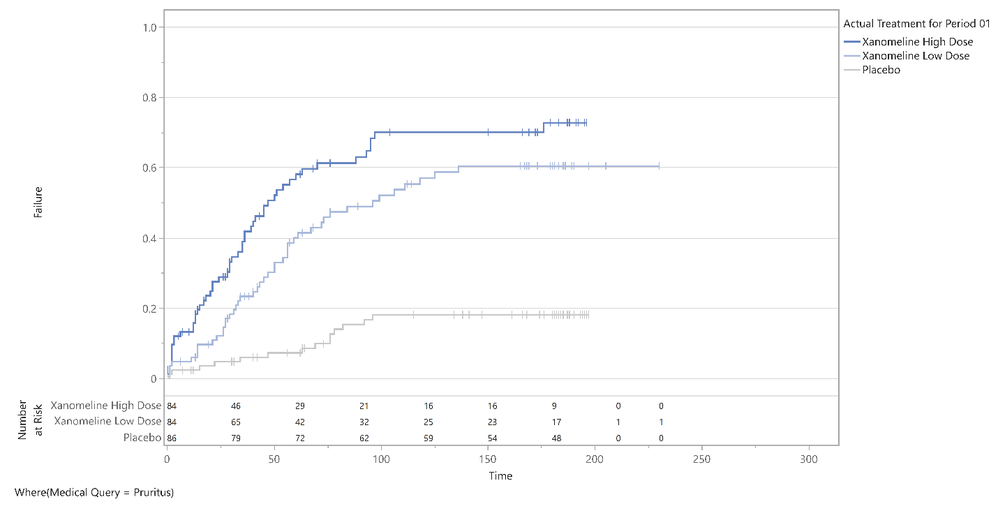

Perhaps unsurprisingly, an analysis of narrow-scoped OCMQs identifies the pruritis MQ as having the greatest differences between the active doses and placebo, with nearly 75% of high dose patients experiencing at least one pruritis MQ by the end of follow up. This is nearly double the 40% rate for the TTE analysis of the pruritis PT in Figure 3!
Figure 9. Kaplan-Meier plot of OCMQ pruritis (narrow scope)Figure 9. Kaplan-Meier plot of OCMQ pruritis (narrow scope)
