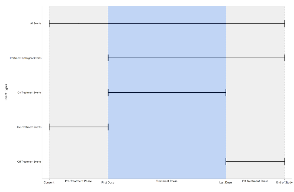

Figure 1. Follow-up for particular adverse eventsFigure 1. Follow-up for particular adverse events
The events of interest can be broken down into these subgroups:
  • All Events: Any AEs that may occur on study once informed consent is signed until the patient ends study participation.
  • Treatment Emergent Events: Any AEs that may occur on or after the first dose of study therapy determined by the treatment arm.
  • On Treatment Events: Any AEs that may occur on or after the first dose of study therapy and before or at the last dose of study therapy.
  • Pre-Treatment Events: Any AEs that may occur prior to the first dose of study therapy.
  • Off Treatment Events: Any AEs that may occur after the last dose of study therapy.

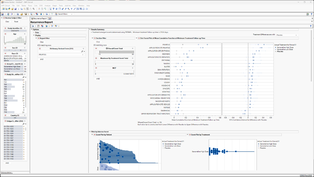

JMP Clinical 19 solves many of the above issues with Recurrence Report. The analysis is quick, highly visual, and interactive. Further, Recurrence Report leads with a summary across all AEs to help identify particular AEs with notably large MCFs or differences between treatment arms. Treatment emergent adverse events are summarized in the analysis described in Figure 2 and beyond. The CDISC Pilot study includes data from 254 patients randomized to one of three treatments (xanomeline high dose, low dose, or placebo) for a 26-week treatment period; 242 different AE preferred terms were observed.
In the Siddiqui paper, the confidence intervals for MCF were obtained at the end of follow-up for each treatment arm. Rarely, in practice, will treatment arms have identical maximum follow-up time. JMP Clinical 19 takes the approach of analyzing treatment arms at the minimum of the maximum (e.g., the minimax) follow-up for each treatment arm so that all treatments are compared at a particular slice of time. In Figure 2, the minimax follow-up time is 210.6 days, corresponding to roughly 30 weeks.
Figure 2. Recurrence report dashboardFigure 2. Recurrence report dashboard

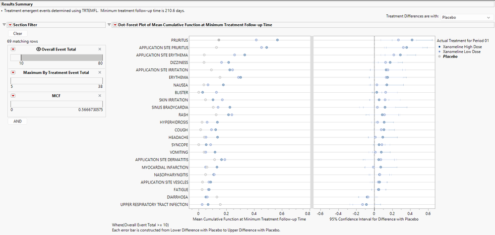

The initial summary of all TEAEs is presented using a dot-forest plot (Figure 3), which is commonly used to summarize incidence analyses among AEs. Here, the dots in the left panel represent estimates of the MCF, while the confidence intervals in the right panel represent treatment differences in MCF between the two doses of xanomeline and placebo at the minimax follow-up. The control group for the confidence intervals can be modified using the combo box. The y-axis is sorted by the maximum difference with placebo with pruritis (itching, to us non-clinical people) exhibiting the greatest difference. Here, estimates of the MCF are 0.567, 0.414, and 0.145 for xanomeline high dose, xanomeline low dose, and placebo, respectively. So, for example, at the minimax follow-up of 210.6 days of treatment, the average number of cumulative pruritis events experienced by patients in the xanomeline high dose arm was 0.567. In other words, a pruritis event is experienced by roughly 1 in every 1.76 (1/0.567) patients at 210.6 days after the start of treatment for patients in the high dose xanomeline arm.
Figure 3. Dot-forest plot for TEAEsFigure 3. Dot-forest plot for TEAEs
The remaining plots in the report are specific to an individual preferred term, which allows for a deep dive into specific events based on the contents of the dot-forest plot. By default, the preferred term with the maximum difference with placebo is presented (here, pruritis), but users can select any event using the Report Filter in the Display Options (left side of Figure 1).

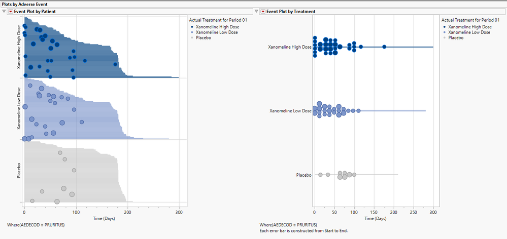

A pair of event plots, sometimes referred to as swimmer plots, illustrate the occurrence of pruritis events over the trial (Figure 4). The left plot summarizes individual patients sorted by treatment arm and length of follow-up. Bubbles indicate the occurrence of pruritis events with bubble size indicative of the number of events occurring at any given time. In practice, the time of day that AEs occur is rarely captured, which means that event plots will tend to summarize the number of events that occur on a given day. In our example, while it appears some patients experience more than one event, with some even experiencing more than one pruritis event on a particular day, most patients do not suffer a pruritis event over the course of the study. The right plot collapses the information in the left plot to a single treatment-specific line, drawn to the maximum follow-up of each arm (recall, this is 210.6 days for placebo). Here, it is more straightforward to interpret what is happening at the treatment level. Patients on the xanomeline arms experienced pruritis events right away, with most events reported through Day 100 and limited events reported thereafter. Most placebo events appeared to have occurred between Days 50-100. Note that bubbles represent the events that occur for a particular patient for a particular time.

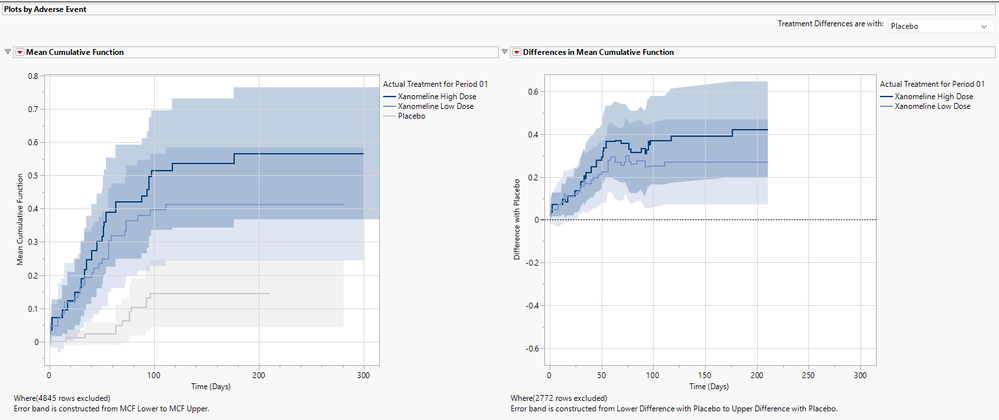

Figure 5 displays greater statistical detail by summarizing the estimates and pointwise 95% confidence intervals for the MCFs (left plot) and the treatment differences between MCFs (right plot). Plots of the MCF allow us to interpret whether there is any change in the rate at which events occur over time. A relatively straight MCF implies that events occur at roughly a constant rate. A curve that concaves up (like a cup) implies that the rate of events is increasing over time, while a curve that concaves down suggests the rate of events is slowing. For our pruritis example, the curve concaves down, implying that the rate of itching events decreases, though the two xanomeline arms had a relatively constant rate up to Day 100 or so. Because AEs are self-reported, whether this decrease in event rate is due to an actual slowing in the rate of itching events (due to improved tolerance or poorer treatment compliance) or due to reduced reporting requires additional data.
Figure 5. Plots of MCF and treatment differences for MCF for pruritisFigure 5. Plots of MCF and treatment differences for MCF for pruritis
The plot of treatment differences in MCF (right) illustrates that after approximately Day 25, both active treatment arms illustrate an excess of itching events compared to placebo (since the shaded area excludes 0). Note that the control group for the confidence intervals can be modified using the combo box.

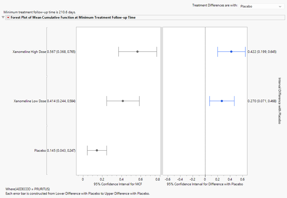

Finally, the dual forest plot presented in Figure 6 gives a snapshot of the estimates and 95% confidence intervals for the MCFs (left) and treatment differences in the MCFs (right) at the minimax follow-up. Here, the estimate and 95% pointwise confidence interval for the xanomeline high dose MCF is 0.567 (0.368 and 0.765). In other words, we are 95% confident that the average number of cumulative pruritis events after 210.6 days of follow-up is between 0.368 and 0.765 events, or one pruritis event for every 1.3 (1/0.765) to 2.7 (1/0.368) patients. The control group for the confidence intervals can be modified using the combo box.
