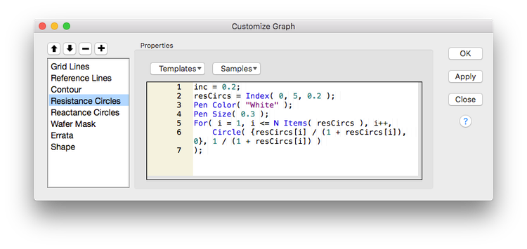

Graphics Scripts
Open up a plot in JMP – any 2D plot....Go on, I’ll wait….
Ready?
Right! Right-click on the graph area and look toward the bottom. Do you see the “Customize…” option? Have you ever explored that option? Most people haven’t. I expect that will start to change because of JMP 14 (Boundary Map), but up until now, I don’t think it’s been a very common area of use in JMP. Which is a pity, because you can do so much with customizations. And it turns out that a Smith Chart is really easy to create by adding Graphics Scripts to a plot’s customizations.  Now, some of you have probably broken into a cold sweat because I used the “s-word” – no, not that s-word I meant “scripts.” But, remember, all we need are circles, a line, and labels, and these are easy to script. I’m also going to add a shape to create a mask around the bits we don’t need and to make the labels easier to see. Here’s how we make each of those as seen in the Smith Chart below.Customize Window.png

Drawing Circles
Circles use the Circle({<x>,<y>},<radius>) command in a Graphics Script. Here’s the script I used for the circles with their centers on the line y = 0 in the example (the green text describes what each part does).
// make a list of circles using a desired step and range of resistances
inc = 0.2;
resCircs = Index( 0, 5, 0.2 );
// set line color and weight
Pen Color( "Gray" );
Pen Size( 1 );
// loop through the list of resistances, calculate and plot a circle for each one
For( i = 1, i <= N Items( resCircs ), i++,
       Circle( {resCircs[i] / (1 + resCircs[i]), 0}, 1 / (1 + resCircs[i]) )
