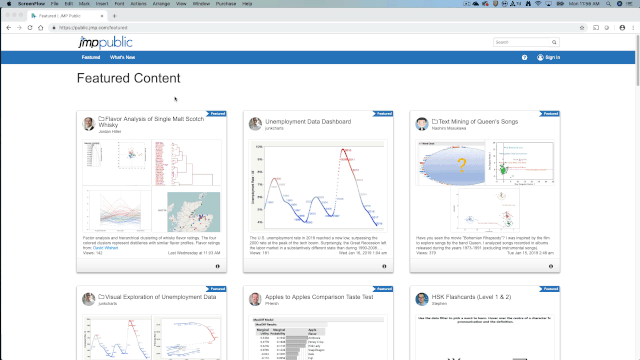

JMP Public is your platform for sharing JMP data, visualizations and dashboards. Prepare your reports in JMP and then publish them to JMP Public.
JMP Public offers the visual interactivity of JMP to explore your data, and lets you:
  • Store all of your reports in one location.
  • Maintain up-to-date reports, dashboards and visualizations in an easily accessible location.
  • Extend the functionality of JMP Public reports to other locations. You can embed and interact with your JMP Public reports in web pages, blogs, social media posts and more.
In this blog post, we will discuss a couple ways to publish your reports to JMP Public. We won’t actually browse the reports on JMP Public in this blog post (although you can explore them right now!), so most of our work will take place in JMP. If you want to learn about using JMP Public, read my previous blog post.

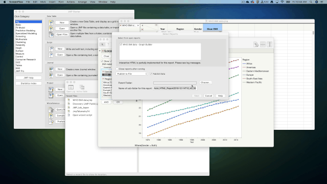

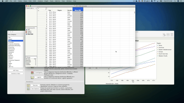

Now that you have created a JMP Public account, you can begin to publish to JMP Public. To do so, you first need to create a report in JMP. As an example, I will use public data available from the World Health Organization. After building your graph in JMP, follow these steps to publish your results to JMP Public.
  1. With the report open, go to File > Publish.
     2. In the dialog box that opens, select the report and Publish to JMP Public.
     3. Customize your report, adding a title and a description as needed and Publish.
Note: The first time you Publish to JMP Public, an alert will pop up. Please read and understand this message before continuing.
When JMP automatically opens your web browser, you can see that your report was successfully published to JMP Public.
