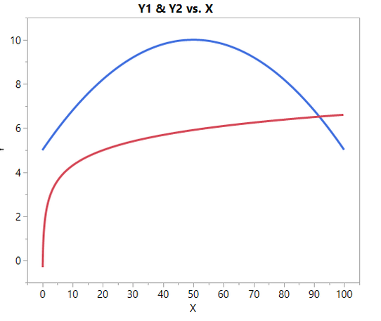

But the models shown in the graph below are also linear models:
 These linear models that are not straight lines have formulas like:
In these models, the betas are the parameters and the X’s are the independent variables. So, perhaps the way to look at this is that in a linear model there is only one parameter in each term of the model and each parameter is a multiplicative constant on the independent variable(s) of that term.

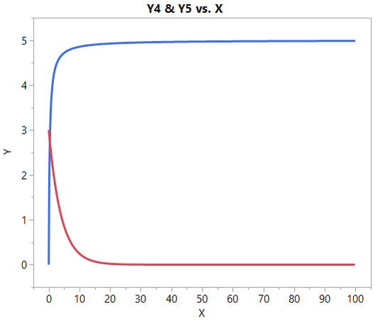

In contrast, a nonlinear model does not have this simple form. Examples of nonlinear models are:
These models may not look very different from the linear models when you graph them:
However, mathematically they are very different because the derivative of these models with respect to any parameter depends on this or other parameters. These nonlinear models require an iterative estimation process, which is much different from using a formula to obtain least squares estimates for a linear model.
