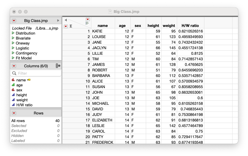

Below is a JSL script using the JMP 18.0 features to take a JMP data table and add a column that is the ratio of two columns from Python. It is performed live on the current data table:
It results in this log output:
<class 'jmp.DataTable'>
Big Class
nrows: 40
ncols: 5
name
age
sex
height
weight
KATIE
0

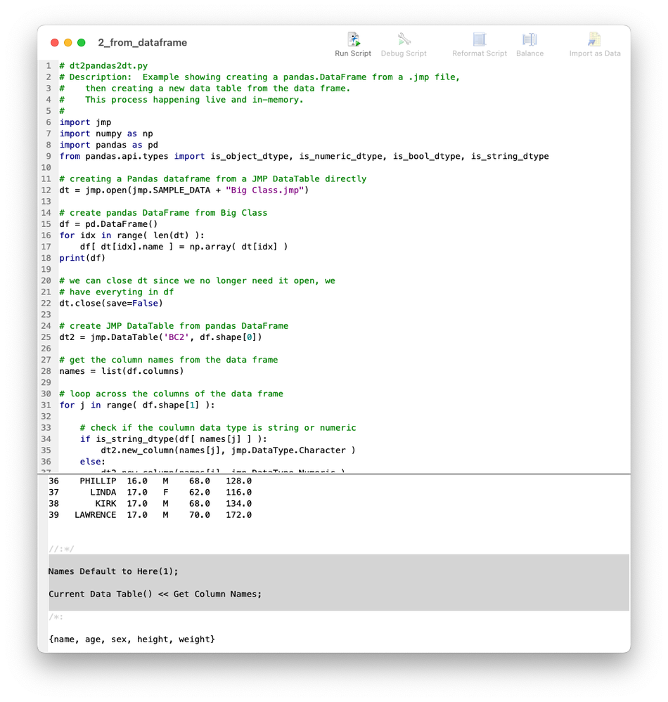

Next, let's see how to work directly from Python. Below is a Python script that:
  • Opens Big Class.jmp.
  • Creates a pandas data frame in-memory from the jmp.DataTable object.
  • Closes Big Class.
  • Builds a new JMP data table from the DataFrame.
  • Prints the column names of the current data table in JSL.
The current table is the one just created in Python.

The following log output is the result:

Names Default to Here(1);
Current Data Table() << Get Column Names;
{name, age, sex, height, weight}
