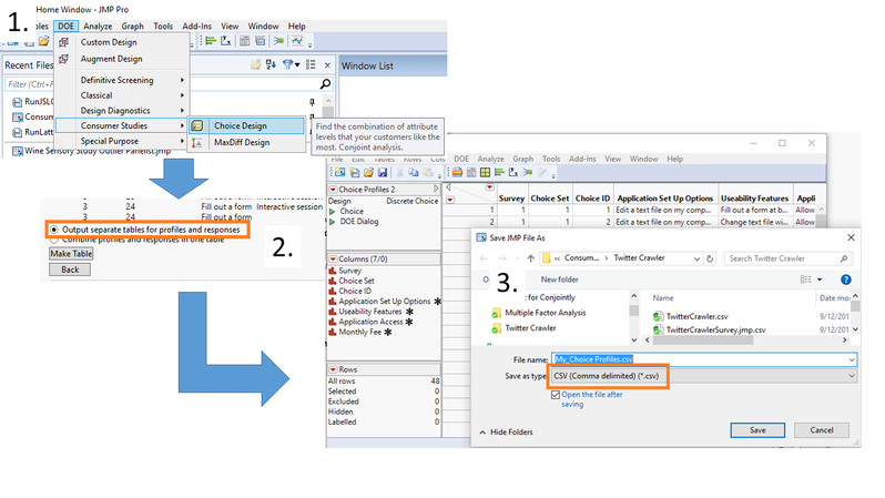

Just create your design in JMP and export the Choice Profiles as a *.csv file.

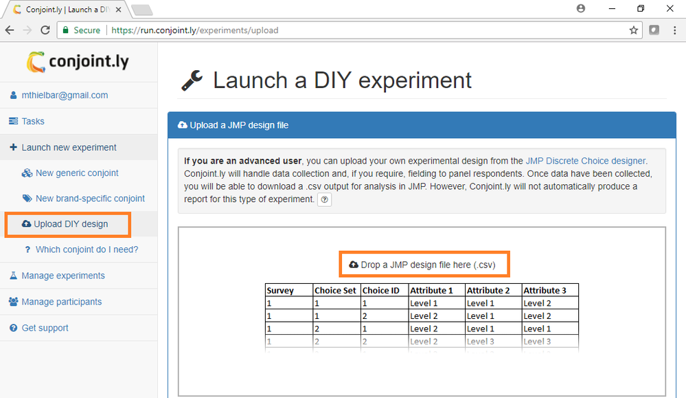

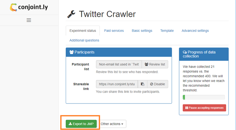

Conjoint.ly also exports to a *.csv file that you can use to analyze your results in JMP. Just click the Export to JMP button when you’re ready to analyze your results.

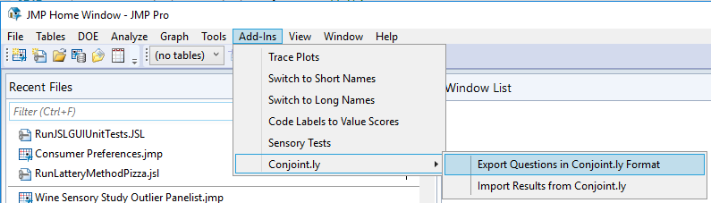

Conjoint.ly’s interface is easy to use all by itself, but I’ve written a pair of JMP add-ins for export/import that will make your life easier. The export add-in checks column names to make sure you have the right layout for a Conjoint.ly survey. The import add-in also does a column name check and automatically opens the Choice platform with the right columns populated.
