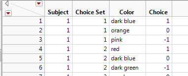

The first few rows of the data table from the MaxDiff designer are presented below. The Choice Set column refers to a grouping of three colors presented together. In the Choice column, 1 represents the favorite from the choice set, and -1 is the least favorite.

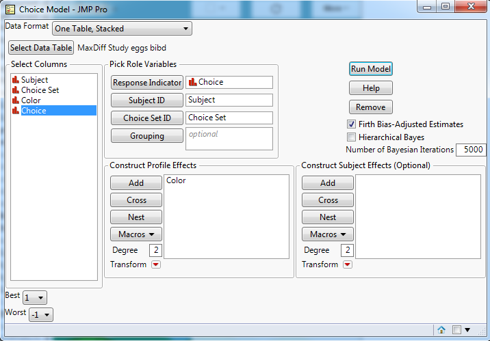

The new MaxDiff analysis platform can be found under Analyze->Consumer Research->MaxDiff. Selecting our data table, we now have to set the columns to the appropriate roles. Subject ID is the column Subject (although we only have one subject), and Choice Set ID is the Choice Set column. The Response Indicator, where we recorded the selections, is the Choice column. We only have one profile effect – Color, containing the nine different colors (treatments). This is what the platform looks like before running the model:

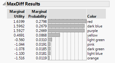

Looking at the results, we can see the relative ranking of the colors:
I turned the results into a data table, and added a label for the Color column and row colors to look at the results in Graph Builder:results GB.png
The marginal probability reflects the estimated probabilities if everything were presented together. What we see is that my daughter really liked red, purple, and dark blue, with yellow a distant fourth, followed by the remaining colors.
I found it curious that the three colors were grouped together at the top. Knowing that each pair of colors was compared once in choice sets, I went to examine those particular choice sets. In choice set 2, red beat dark blue. In choice set 3, dark blue beat purple. In choice set 6, where red and purple are together, you might think that red beat purple. But, purple was chosen above red, resulting in that grouping at the top. I guess the ease of the data collection might have been a bit misleading….
