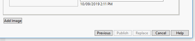

If you are publishing multiple reports at once, you can add images. So, another way to share the result of your analyses without sharing your data is to save your reports as images, then add them when publishing. You can save reports as images using File > Save As with ‘Save as type:’ PNG, JPEG, GIF, or TIFF. When publishing multiple reports, you would use “Add Image” in the “Configure Report” dialog under the report previews to choose an image to include. The “Add Image” button can be used multiple times.

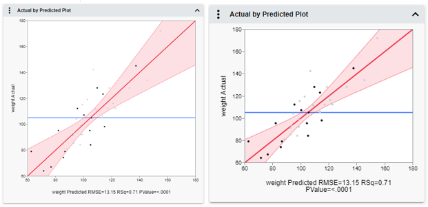

Tip #3: Consider the size of devices that will display your report
When sharing JMP scripts with colleagues who have JMP, it’s often safe to assume that if it looks good on your computer, it will probably look good on theirs. If it doesn’t, they can easily resize graphs within JMP. When you publish reports to JMP Live, however, your colleagues could be viewing what you’ve published on mobile devices, which typically have smaller screens.
When the graphs don’t fit on their screen, they can usually zoom to fit, but then the titles and axes might become too small to read. So, just like when you’re preparing a presentation and you want to make sure the text in your reports can be read from someone at the back of the room, you should not create graphs so large that the titles and labels look tiny in comparison. Here’s an example of two graphs shrunk down to fit this blog post. The graph on the right started out smaller, so its text is easier to read than the left.

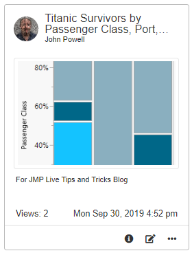

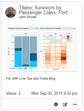

Tip #9: Customizing Thumbnails
Thumbnail images are generated when you post to JMP Live. They show up on cards throughout JMP Live. JMP uses the first graph in your report as the thumbnail, but this may not always be what you want to emphasize or use to catch the viewers’ attention. For example, if you build a dashboard, like in Tip #7, you might want to show more than one graph in the thumbnail.
To customize a thumbnail, you first need to capture an image or otherwise obtain an image to use as the thumbnail. Windows 10 includes an application called the “Snipping Tool” that allows you to capture a rectangular area of your screen and save it to an image file. On the Mac, you can use the shortcut (Command+Shift+4) to do the same. The thumbnail display is a bit wider than its height, so try to capture a rectangle that is approximately the same shape. It will be scaled to fit but clipped if it is too tall or wide.
To upload a new thumbnail in JMP Live, open the Edit Details dialog by clicking on the pen icon. Then click on the thumbnail, and you will be provided with a way to find and select the image file.
Cards for folders will use up to four of the child thumbnails to make up the folder thumbnail. You can override this with an image of your own in the same way you update a post’s thumbnail.
