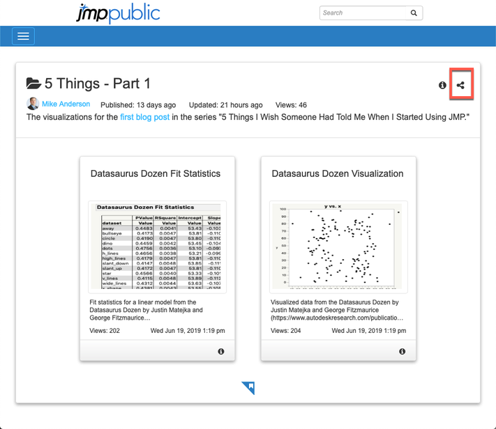

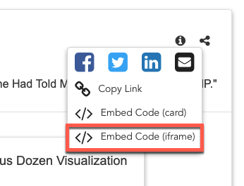

If you don't have your JMP Public page open, do so. Go to the icon in the upper right-hand side of the window.JMP Public Screenshot 1.png
Select "Embed Code (iFrame)" from the list. You've now got the HTML code needed to embed the content for that report using something called an iFrame. JMP Public Screenshot 2.png

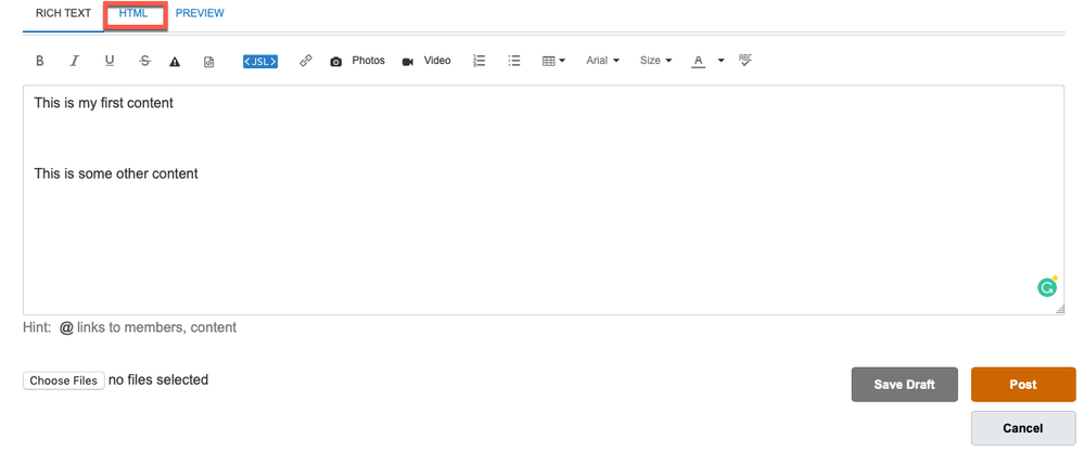

In my case, I created a new blog article, and this opened an editor. In the editor, I have the option to work in Rich Text (what most people do), to see the HTML code (most people pretend that doesn't exist), and then get a Preview of what I'm going to get when I click "post."

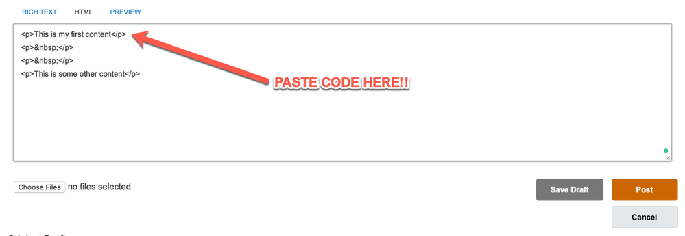

When I click the HTML tab, the editor shows me the code for what I've written in the Rich Text tab.
All I have to do is locate the point where I want to insert the iFrame code is and paste it there. I find this is easiest to do by entering a couple of blank lines where I want my iFrame to go. Then I have to find them in the HTML (they look like this: "<p>&nbsp</>") and then locate the last paragraph marker (looks like this: "</p>") before them. I put my cursor there (you can start a new line if you'd like) and hit paste (CTRL or command + V). It should look like this:

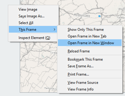

2. When a report is large and needs scroll bars, you can provide a handy tip for Firefox users viewing your blog or web page: "If you are using Firefox, right click on the embedded report and choose  'This Frame > Open Frame in New Window', to see the whole report in a new window".

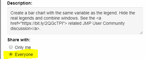

3. When embedding a report like this, make sure the report on JMP Public or JMP Live was set to share with Everyone.
