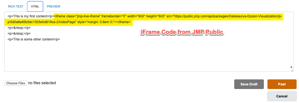

All I have to do is locate the point where I want to insert the iFrame code is and paste it there. I find this is easiest to do by entering a couple of blank lines where I want my iFrame to go. Then I have to find them in the HTML (they look like this: "<p>&nbsp</>") and then locate the last paragraph marker (looks like this: "</p>") before them. I put my cursor there (you can start a new line if you'd like) and hit paste (CTRL or command + V). It should look like this:

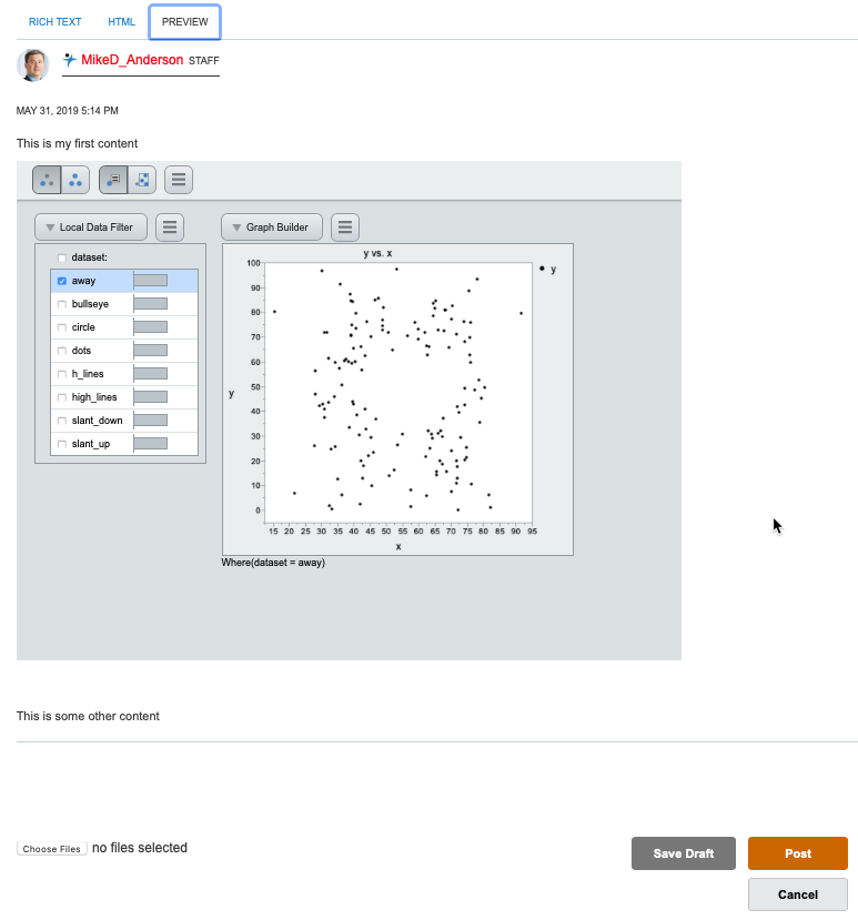

Now that the iFrame is in the HTML, I can go the Preview tab and have a look at the embedded JMP Public content.
And that's it. A little cutting and pasting, and you can integrate JMP Public content into a blog post or webpage. The only legwork you may need to do is research the specific method for inserting an iFrame, but it should look similar to the one I've shown here.
