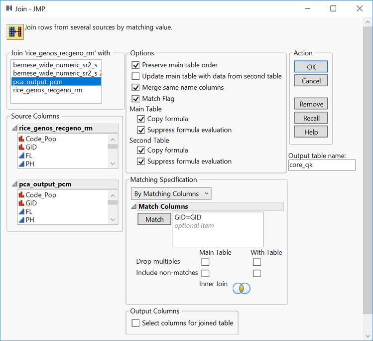

  3. With the file rice_genos_recgeno_ibd_kc.sas7bdat in the foreground, select Tables > Join.
  4. In the top left box, select the file pca_output_pcm.sas7bdat
  5. Check the box labeled Merge same name columns
  6. Select the variable GID in the two Source Columns boxes, and then click the Match
  7. Assign the Output table name as core_qk.

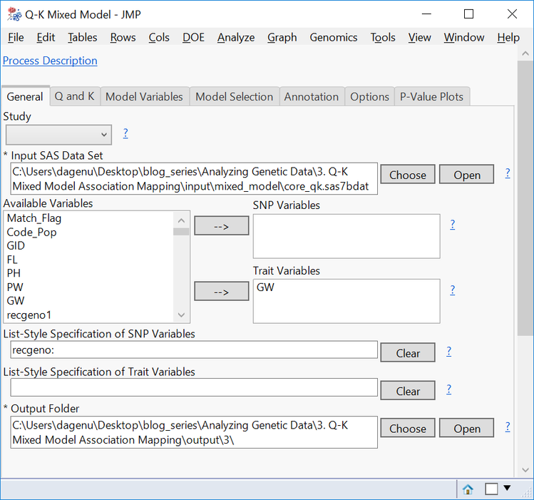

  11. From the Genomics Starter menu, choose Genetics > Other Association  Testing > Q-K Mixed Model.
  12. Choose core_qk.sas7bdat as the Input SAS Data Set.
  13. Select GW as the Trait Variable.
  14. Enter recgeno: in the box under List-Style Specification of SNP Variables.

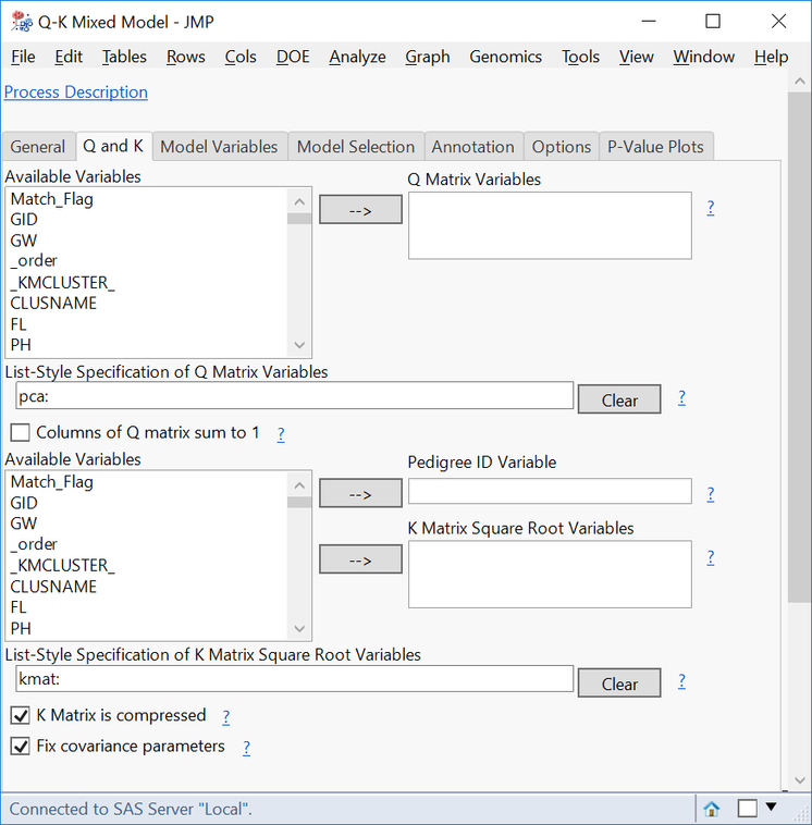

  16. On the Q and K tab, type pca: in the List-Style Specification of Q Matrix Variables box, and type IBD: in the List-Style Specification of K Matrix Square Root Variables
    • If using the compressed K matrix, check the box K Matrix is compressed.

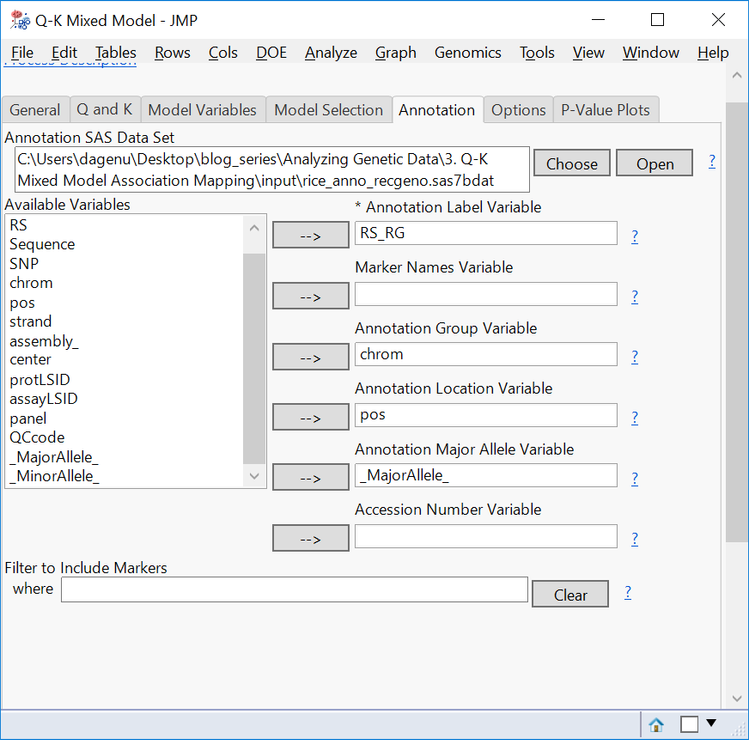

  3. On the Annotation tab, Choose rice_anno_recgeno.sas7bdat as the Annotation SAS Data Set.
  4. Fill out the Annotation tab with RS_RG as the Annotation Label Variable, chrom as the Annotation Group Variable, pos as the Annotation Location Variable, and _MajorAllele_ as the Annotation Major Allele Variable.4_anno.png

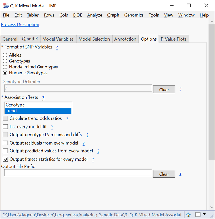

  5. On the Options tab, change the Format of SNP Variables to Numeric Genotypes.
  6. For a shorter computing time, deselect the Genotype Association Test. Optionally, the Genotype test performs chi-square tests based on genotypes, where the Trend test performs a Cochran-Armitage test.5_options.png

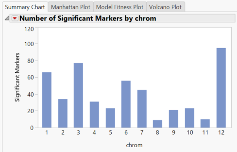

  1. When the results dashboard opens, the Summary Chart tab shows the number of significant markers on each chromosome for the Grain Yield (GW)
    • The blue bars represent results from the Trend test. The trend test looks for a linear relationship in the trend scores when moving from homozygous minor to heterozygous to homozygous major.result_1_sum_chart.png

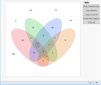

  2. When performing a model on multiple traits, significant markers that overlap across the traits can be viewed and data subsets can be created via a venn diagram output.
    • There are five markers that are significant in common between GW, FL, and PH.result_2_venn.png

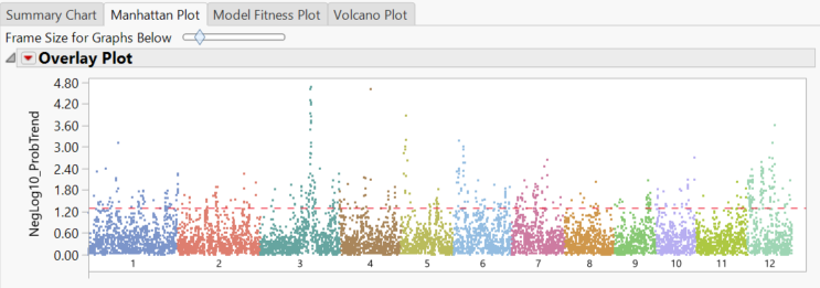

  3. The Manhattan Plot tab once again shows significant markers by chromosome as determined by the trend test.result_3_manhattan.png

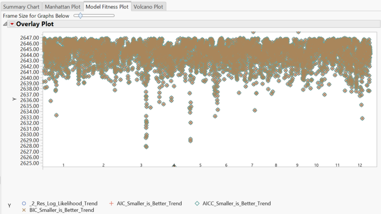

  5. The Model Fitness Plot tab shows fitness statistics for each marker. To separate the fitness plots by model, click the red triangle and select Overlay Plots > Overlay Ys. Tests are plotted by shape, with points lower on the plot representing higher accuracy.result_5_modelfit.png

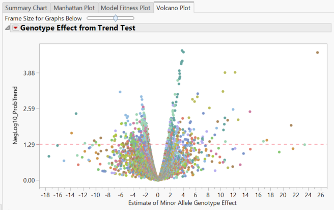

  6. The Volcano Plot tab gives a volcano plot for each marker, with minor allele genotype effect on the x-axis and the log transformed p-value on the y-axis. Points above the red line are considered significant.
    • Clicking through the Local Data Filter options on the right will give volcano plots for each individual chromosome.result_6_volc.png

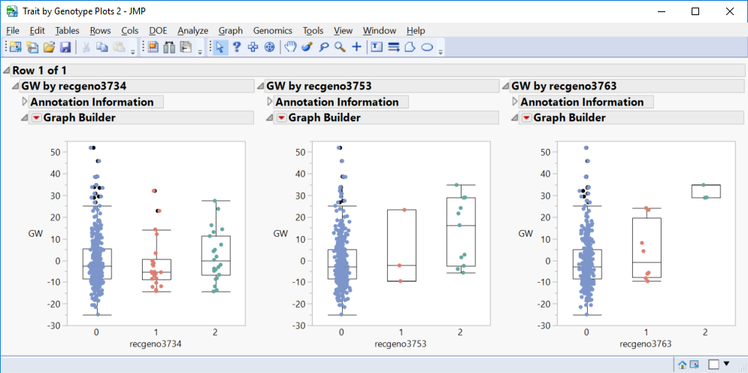

  7. In the Drill Downs menu, a subset can be created for selected markers, or a plot of Grain Yield values by genotype can be created by selecting Plot Trait By Genotype.
    • This is a great way to quickly see the effect different genotypes have on a trait for a given marker.
    • Shown below are trait by genotype plots, ordered by significance, from three markers on chromosome 5.
