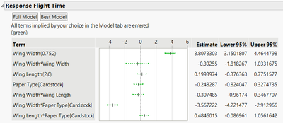

I’m particularly excited about the new analysis tool we’ve added to the Analyze tab for Guided users. Not only is there a button to have Easy DOE identify a best model, but also we can explore different models by adding or removing model terms with a click on its confidence interval in the plot. Give it a try when you get your hands on JMP 17!
