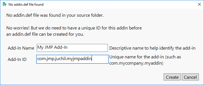

  • If there was not an addin.def file located in the source folder, you will be prompted for a name and ID for the add-in. Enter a name and an ID and click “Create.”

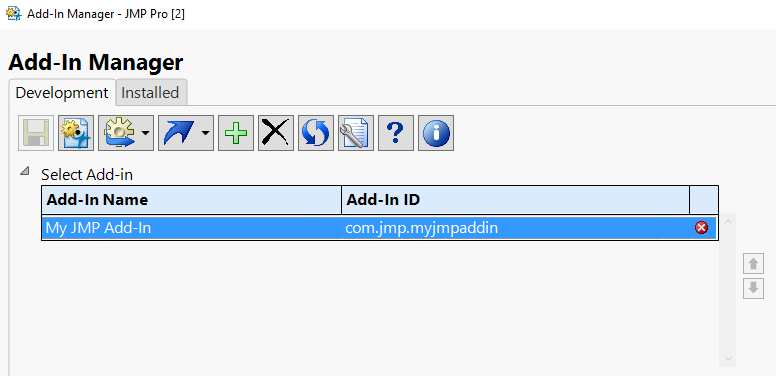

  • The add-in has now successfully been defined in Add-In Manager.

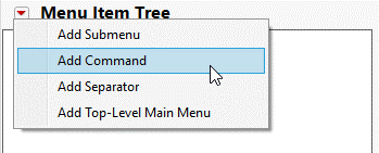

  • You can then add either a submenu or command. In this example, there is just a single command. Click the red triangle menu next to “Menu Item Tree” and select “Add Command” to add a command menu item to the tree. After the command is created, it will have the below default values.Add Command.png

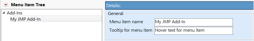

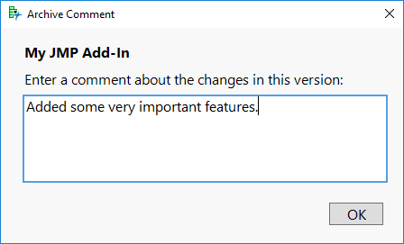

  • If you have automatic archiving turned on, and the Prompt for Comment preference set, you will get a pop-up window with a text box for a comment. This is a good place to store information about what has changed in this specific build of the add-in.
