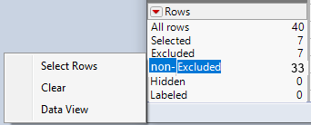

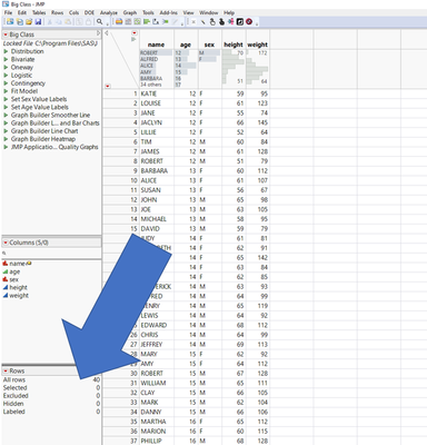

The rows summary table on the bottom left of a table is very useful to get DataViews (subsets) for selected rows, excluded rows and so on.
The Data View
Unfortuntely, in my daily work it's much more often that I need a subset of non-excluded rows than of excluded rows.
So, I go:
3)
my wish: an additional entry for non-excluded rows,
like this
and by this: the opportunity to generate a DataView for non-excluded rows.
Additional benefit:
One can directly see the number of actually used (= non-excluded) rows and doesn't have to calculate it (all rows - excluded)

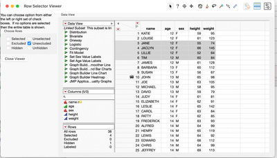

I have been think about this one for a while, and on my short holiday I decided to work on a scripted approach to do this.
We are looking into this, however, to make this easier to.
 Here is my script:
SCRIPT NAME:  Row Selector Viewer
AUTHOR(s):
Sam Gardner, JMP Statistical Discovery LLC
JMP VERSION:
Built with JMP 17.0 and tested with JMP 16.2
PURPOSE:
To allow the user to be able to easily subset and see rows that are selected or excluded or hidden, OR unselected or unexcluded or unhidden
SPECIFICATION:
Views of the desired subset of the current data table are created using linked subsets and data box views within a report window.  Upon selecting an option, an invisible linked
subset of the desired rows to view is created, and then a new data view in a  data box is displayed in the scripted report window.
USAGE:
Must be run with a data table open.
Upon running, choose the subset of the rows to view by selecting the check boxes.  Note that this current version
only allows subsetting based in Selected/Excluded/Hidden or Unselected/Unexcluded/Unhidden
ASSUMPTIONS: None.
SCRIPT REVISION HISTORY:
VERSION	DATE		DESCRIPTION
1.0		2022 Dec 14	First Version
NOTES:
N/A
TO DO:
N/A
FUTURE IMPROVEMENT IDEAS:
None at this time.

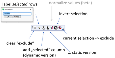

With the introduction of QuickSelect Toolbar  it got a bit easier:
The click count reduced from
- select excluded rows (2 clicks)
- invert selection (rows - row selection - invert row selection = 3 clicks)
- data view for selected rows (2 clicks)
➜ 7 clicks
to
- invert (1 click)
- data view for selected rows (2 clicks) with the new Quickselect Toolbar: 1 click
5 4 clicks

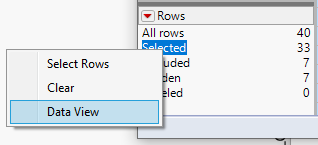

Hm, how about:
- don't add "non-Excluded" to the overview table
- but add Select non-excluded to the right click contect menu of Excluded
are there users who use the hidden functionality?
