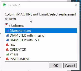

I just saw in @Florian_Vogt 's  JMP17 introductory presentation that the new Workflow Builder catches "missing column" error an shows a window to select a replacement column.
wonderful :)
digging deeper:

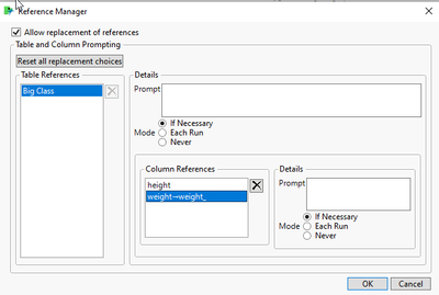

The Workflow Builder remembers the link between original column name and replacement column, but does NOT change the  JSL code, right?
a) Could you please add a button to apply the replacement just once and don't save it for the future
b) Could you please add a button to enable auto-correction of the code. (as an option in the window which asks the user for a replacement column - or as a function in the Reference Manager)
c) at the moment the existence of a replacement rule "overrides" the link to the actual column. Perhaps it makes sense to add an option: use replacement rule just if the original column is missing ?
Most important
Could you please enable this feature also for standard JSL Code execution? :)
