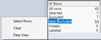

The rows summary table on the bottom left of a table is very useful to get DataViews (subsets) for selected rows, excluded rows and so on.
The Data View
Unfortuntely, in my daily work it's much more often that I need a subset of non-excluded rows than of excluded rows.
So, I go:
3)
my wish: an additional entry for non-excluded rows,
like this
and by this: the opportunity to generate a DataView for non-excluded rows.
Additional benefit:
One can directly see the number of actually used (= non-excluded) rows and doesn't have to calculate it (all rows - excluded)

Concerning my post here, I actually thought about something much tinier - just to add an option for the non-excluded rows to the menu on the lower left of a data table.
To be honest, I am already so used to selecting the excluded rows and then to invert the selection - I would say that such a feature comes would come too late for me.
But as many of my posts - the wishes are not mainly for myself, but more for my co-workers ... and all the other users in the community :)

Hm, how about:
- don't add "non-Excluded" to the overview table
- but add Select non-excluded to the right click contect menu of Excluded
are there users who use the hidden functionality?
then add a similar option to select non-hidden rows

@Sarah-Sylvestre
with all these options available, from my point of view the topic can be closed.
There are other much more important entries in the wish list.
