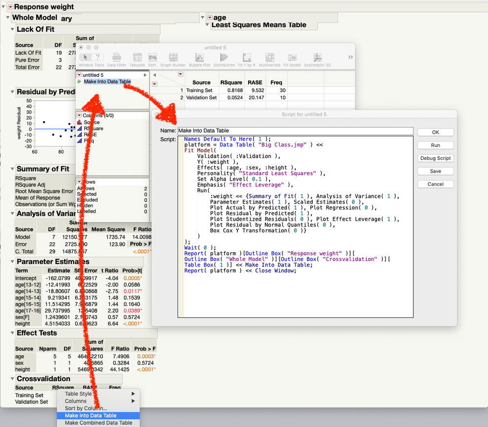

Jeff_Perkinson
Community Manager
A TableBox doesn't have a name, but the OutlineBox does. So, the best practice is to index off of the name of an Outlinebox. In JMP 14, when you right click on a tablebox and Make Into Data Table the resulting data table has a Make into Data Table script that shows how to use the OutlineBox by name to get to the TableBox.
dt = Open( "$SAMPLE_DATA\Big Class.jmp" );
Names Default To Here( 1 );
dt << New Column( "Validation",
	Character,
	"Nominal",
	Formula( If( Random Uniform() > 0.2, "0", "1" ) ),
	Value Labels( {"0" = "Training", "1" = "Validation"} ),
	Use Value Labels( 1 ),
fm = Fit Model(
	Validation( :Validation ),
	Y( :weight ),
	Effects( :age, :sex, :height ),
	Personality( "Standard Least Squares" ),
	Set Alpha Level( 0.1 ),
	Emphasis( "Effect Leverage" ),
	Run(
		:weight << {Summary of Fit( 1 ), Analysis of Variance( 1 ), Parameter Estimates( 1 ),
		Scaled Estimates( 0 ), Plot Actual by Predicted( 1 ), Plot Regression( 0 ),
		Plot Residual by Predicted( 1 ), Plot Studentized Residuals( 0 ),
		Plot Effect Leverage( 1 ), Plot Residual by Normal Quantiles( 0 ),
		Box Cox Y Transformation( 0 )}
rpt = Report( fm );
rpt[Outline Box( "Response weight" )][Outline Box( "Whole Model" )][
Outline Box( "Crossvalidation" )][Table Box( 1 )] << Make Into Data Table;
The script that JMP puts there uses the whole tree of outline boxes. If you're sure there's only one outline box with the name you're interested in you don't need the whole tree:
rpt[Outline Box( "Crossvalidation" )][Table Box( 1 )] << Make Into Data Table;
