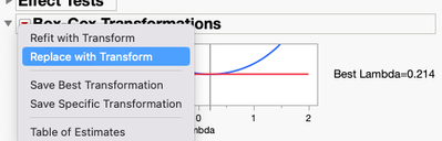

@Grumpybaldprof if you perform the fit on the Box Cox Transformed response (using the Refit with Transform or Replace with Transform) option under the Box-Cox transformation
and then you save the prediction formula for that fit (red triangle > Save Columns > Prediction Formula), that prediction formula has the appropriate inverse transform.  You can then use that column to create plots in Graph Builder.
Does that meet your needs?

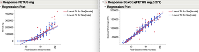

Unfortunately no, this solutions does not help. The reason is simple, the transformation changes the axes values making them useless for biological interpretation. See screenshot below.

Ah now I see, but there seems to be no way in graph builder to have the raw points in the x axis, coded by colour for fetal sex and the 2 curves OVERLAID  from the predicted formula column coloured by sex. Please advise.
