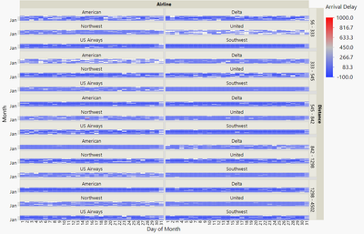

If "Wrap" is used to split a plot into subplots, the titles of the subplots often consume more space than the plots themselves and users want to shrink or remove the titles:

In the right click context menu, there is already an option to enable/disable the title.
would be great to have an option as well for the individual labels of the subplots:

Following an Idea of @XanGregg, I found out that one can remove the titles of the subplots with the option "size(1)" of the Wrap command:
https://community.jmp.com/t5/Discussions/remove-subplot-titles/m-p/563271/highlight/true#M77627
dt = Open( "$SAMPLE_DATA/Airline Delays.jmp" );
dt << minimize window( 1 );
gb = Graph Builder(
	Show Control Panel( 0 ),
	Graph Spacing( 5 ),
	Variables(
		X( :Day of Month ),
		Y( :Month ),
		Group Y( :Distance ),
		Wrap( :Airline, Size( 1 ) ),
		Color( :Arrival Delay )
	Elements( Heatmap( X, Y, Legend( 5 ) ) )
Status changed to: Not Planned For Now
