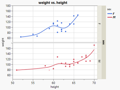

How is it possible to change the Font setting of Y Group in graph builder?
I'm using JMP Pro 14.1
It is not possible to right-click to change those as with e.g the x-axis.
The Group font and font size are controlled by the "Text" size as specified in the Preferences for JMP.  They are not controlled as an individual graph by graph setting.
     File --  Preferences -- Fonts
It would be nice to be able to control the fonts by right-clicking

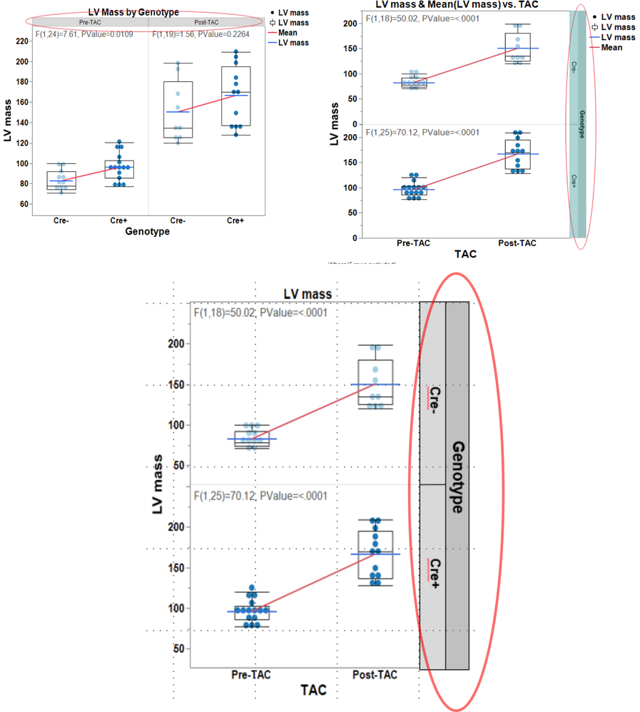

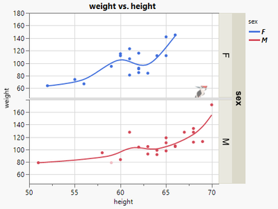

I agree that this has been frustrating and one of the main reasons our group has not widely implemented JMP for visualization.  For instance, the seeming inability to change the size of the fonts in the first two images below means that using the graphs in presentations requires extra steps to make the labels viewable.  We have to make text boxes with legible sized fonts to paste over each graphs from JMP that we would like to use.  Maybe this oversight will have been fixed in JMP17?
