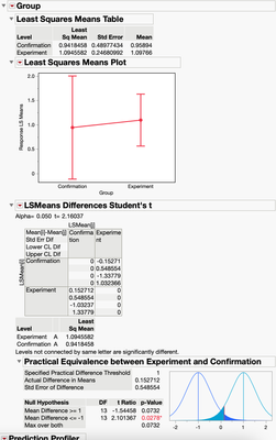

@ASTA thanks for the idea.  You can do this, currently, in JMP if you add the additional experimental rows manually, and add a grouping column with labels for the runs (e.g. "Experiment", "Confirmation" as the group labels), and then run the same model but add the group column into the model.  Within the effects you can do an equivalence test, underneath the multiple comparison's analysis (LS Means Student's t, or other comparison).   Does that meet your needs or are you looking for something else?
SamGardner_0-1665679638106.png.
