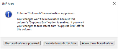

It would be great to have the opportunity to trigger the evaluation of a formula with "suppress eval" just "once":
Formulas using  "selected()" or "excluded()" are very useful to highlight selected data or to remove excluded data from lists, calculations and displays.
On the other hand, when working with large data sets, the usage of such formulas leads to many waiting times - because any change of the row state triggers a re-evaluation of the formulas.
A compromise: default option for such formula: suppress eval
and an option to trigger the formula evaluation just once, e.g. via right click context menu of the "+" formula sign.

hogi
Level XIII
after bugfixing the issue with the excluded() states in Jmp18 (What makes the formula evaluate over and over? )  this wish gets less important :)
