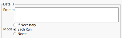

If the user wants to run the same workflow with different input files (leading to tables with different names), the data table reference in the workflow steps has to be changed accordingly. This can be done via the Reference Manager and the option Allow Replacement of References:

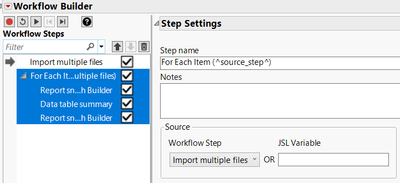

In Jmp 18 the Workflow Builder made a step towards Workflow Manager:
Now it's possible to add "advanced" steps like If/Else and For Each Loops.
A very nice feature (***)
the return value of one step can be used as an input for another step - wow!
e.g.
MFI → list of tables
→  (input)  For Each

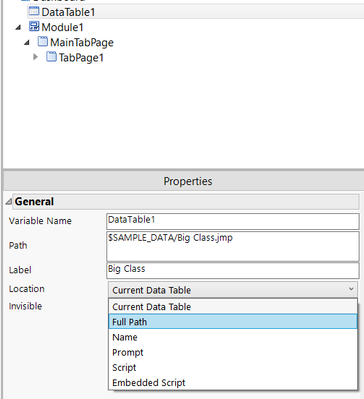

... similar to the Data Table options in Dashboard Builder:
