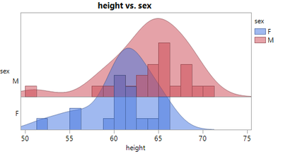

If it's just about a cool looking curve without the Gaussian Fit statistics, one can use histograms 2x with bar and Density setting.
The two Overlap Settings can be used to fine tune the heights.
