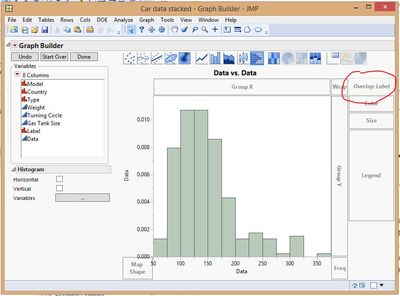

This is *exactly* what I want to do, but unfortunately the instructions for the "graph builder" option are not working.
I have pulled up the sample data set, stacked the columns as instructed, and followed along exactly and it works fine until I get to the instructions to drag the "Label" column into the "Overlay" role.  When I do that, nothing changes in the graph.  I still see a histogram, but all the data is lumped together, not separated out into 2 overlaid color groupings like the author's illustration.  What is going on here?  I am running JMP 11.2.0.
This is a screen capture of the window:
Thank you!

Hi Lirpsa,
Thank you for bringing this to our attention. You are correct -- the Overlay role in JMP 11's Graph Builder does not distinguish color for the Histogram element. If you have a site license, you can contact us in Technical Support (support@jmp.com) and we can help you upgrade to the current version, JMP 14.2. If you have a single-user license of JMP 11, this doesn't include major version upgrades. In that case, feel free to contact our JMP sales department at 877-594-6567.

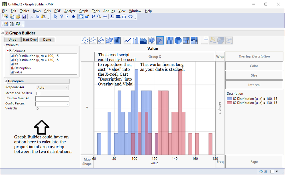

Regarding summarizing the request it is basically this:
1. In a very similar way that JMP performs univariate analysis and presents histograms/summary statistics using Analyze>Distribution, enable JMP, in the Graph Builder Platform, to overlay at least two distributions, fit a normal distribution curve to each distribution individually, and automatically compute a proportion of area overlap between the two distributions.  See the attached image:
2. Note there have been various good contributions on the user community in this direction in addition to this wonderful post by @sseligman  - This courtesy of @ms , https://community.jmp.com/t5/Discussions/is-there-a-way-to-find-the-area-common-to-two-different-nor... where they created their own JSL to perform this operation.
I attach the script here for conveniece:   In the end, the most desired one would be what I am describing above, and what is being computed and illustratred schematically with the JSL below.

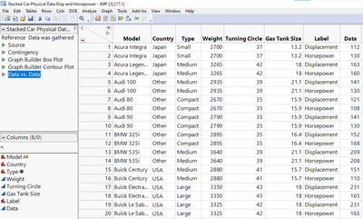

Hi @DecileDromedary Sure! Using the Graph Buidler approach, after you're done making all of the customizations, you can to go the to the red triangle menu and select Save Script > To Data Table:
JMP will produce a script (in my example, named "Data vs Data") and write it to the data table where you can access it in the upper left-hand corner by clicking the green play button next to the script name:
Here is what that saved data table script might look like (I generated this in JMP 17.1):

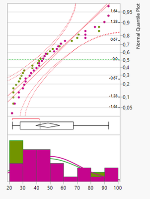

Hi @DecileDromedary You're welcome! Unfortunately, I don't think this workflow is easily reproducible (in JMP-generated script), even with JMP's recent Enhanced Log (JMP 16) and Workflow Builder (JMP 17).  Of course, there may be way to script this in JSL from scratch but that would be a lot more work (beyond scope here).
Can you please add commentary (similar to the above) regarding your request to the following Wish List post?
https://community.jmp.com/t5/JMP-Wish-List/Support-for-overlaying-multiple-distributions/idi-p/35924...
Your ask is similar to what is being requested there, see the screen capture there from @shampton82:
If a plot like the above were built into Distribution or Fit Y by X, then you could save that script to your data table just like I showed in Graph Builder.
This will help us consider your request as a feature enhancement in Graph Builder in a future release of JMP.
