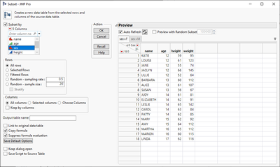

At least in JMP17 the information isn't lost (it seems to be saved as table variable), but I think (optional) naming which would use the value which the subsetting has been done by would be helpful. JMP17 seems to be able to do that subsetting already with the name BUT there is some sort of a bug (using JMP17.0, not sure about 17.1).
Preview does show sex=F and sex=M

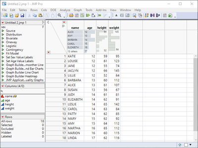

but I end up with Untitled 2.jmp 1 and Untitled 2.jmp 2 (there is sex table variable)

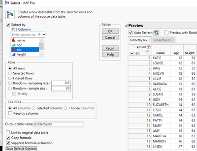

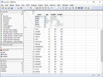

If I go back to subsetting, use Recall and recreate the tables I do get tables named sex=M and sex=F (maybe it would be nice to also see what the original table was?)
If I recall and then change "Output table name" option the names will get updated and I would guess this is the "bug" which is happening if you don't use recall
