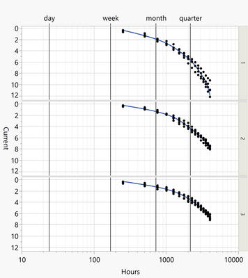

Do you know how many seconds add up to one month?
No need to remember - with a combined time scale like this one:
hogi
Level XIII
One can create such a plot by using the functionality for the Y axis, and then rotate the graph by 90°. (doesn't feel like "JMP" - but generates the plot. Just the final Y axis looks strange).
