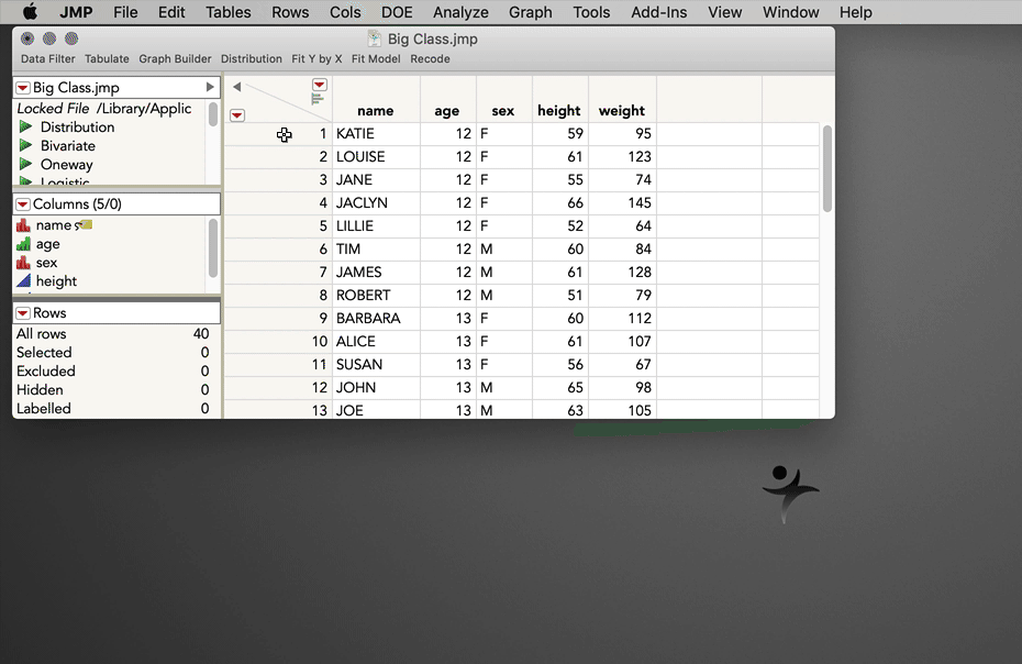

Hi @Jim_Gillard,
I completely understand the need for focusing attention on particular rows. In JMP, my favorite way to do this is the Data View, which you can invoke by selecting whichever rows you wish to focus on, then right-click the Selected line in the Rows section of the data table, then select Data View. The new table view you get is a linked subset of the table, allowing you to make edits, create selections, or simply view just that subset of the data (see gif below). Once you're done viewing that subset you simply close the table.
I have found this to be a much more effective way to focus attention than hiding rows, which I used to do in Excel as well. Hope this is helpful.

I found the data view.  Was right clicking in the wrong place.  This is just a shortcut to doing a Table>Subset however is handy.

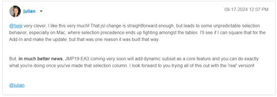

I think  @jules 's Dynamic Subset Add-In (Filterable Data Table, updated) is what you want.
Either directly, to filter the data that you want.
Or even via Excluded() - just add a formula column with formula = excluded() to directly toggle excluded / non excluded rows on and off.
@jules
how about adding such a yes/no selection for excluded /non-excluded rows directly into the DynamicSubset Add-In?
