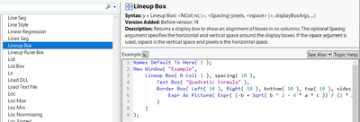

It's not the only place where the Scripting Guide doesn't show the full potential of the JSL function:
    (just kidding)
