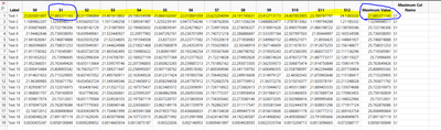

@jthi Thanks. Your code finds max value across column it seems and I want to evaluate max value of each row across multiple columns. I am expecting the following results

Re: Searching Maximum value of each row across several column and name of source column
I had copy-pasted some very weird script, I have now edited it to correct one
-Jarmo
