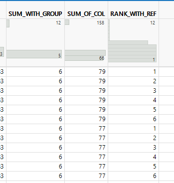

		Try( // with reverse_tableorder = 1, :age is taken from correct table BUT the group sizes from wrong?
		// KATIE -> 72 (6*12) and not 11+12+12+13+14+15 -> 77
			new_col = dt << New Column("SUM_OF_COL", Numeric, Continuous);
			new_col << Set Each Value(Col Sum(:age, :name));
			show(exception_msg);

but Col Sums seem to still have an issue ...
this issue can be fixed by explicitly referring to dataTable:column, analogous to Jarmo's example in the fist post:
new_col = dt << New Column("SUM_WITH_GROUP", Numeric, Continuous, << Set Each Value(Col Sum(1, dt:name))); // dt:name instead of name
new_col << Set Each Value(Col Sum(dt:age, dt:name)); // dt:age(name) instead of :age(name)
