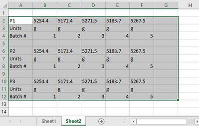

  • In a second article I will cover the horizontal structured data case. That is first row/first column is the parameter name, in the following columns is the data. In the second row are the units, in the third row the batch number. Then an empty row and after that the same thing again for another parameter. This is easier to read in a spreadsheet but actually not very easy to analyze. I often see these kind of data, although it would be much better to train people to enter data in the vertical way than trying to workaround with the horizontal structure.

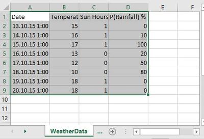

So let's take a look at the spreadsheet data, it's weather data, and it is simplistic for demonstrating the concept. Attached you will find the script in the JMP Data Table and the Excel spreadsheets for the first case.
Let's start with the situation
We have already imported an earlier version of the spreadsheet (3 rows of data to that point of time). Now we want to update the data table. You see an update script in the left top window of the data table. This script will do the following:
  1. Access the current data table name and the number of rows in that data table
  2. Set the spreadsheet file name and worksheet name we want to get the new data from
  3. Opens the spreadsheet and read the worksheet data into a help data table.
    1. We rely on the source script generated when we imported the data the first time.
    2. But changed the "Data Starts on Row" entry from (2) to (2+n_Rows), so we only get the data we have not already imported
  4. Now we only have to concatenate the two tables using the "Append to first table" option.
