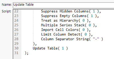

nice workaround mentioned by @christian-z in
Is there a way I can refresh the 'Source' data without it launching a new table? Or is it possible f...
store the test file in the Cloud and use a Data Connector.
e.g. Sharepoint/OneDrive adds an Update Script which can retrieve new data and update the data table.
