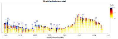

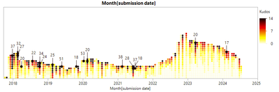

big dots/labels: wishes from the JMP Wish List Prioritization Survey!
Kudos = 14 (black) -- or 17- 37 (labels)?
To fix the issue one can add a steep trend at the end of the color scale
to mark "out of range" points with another color:
