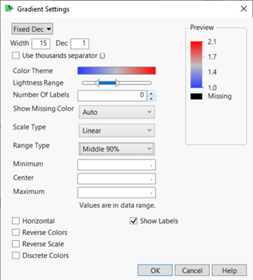

In graph builder, is there a way to set the default color code gradient range to "Middle 90%"?
by @tsg.
Up to now, there was no reply - and I could not find a related wish ...
What is the improvement you would like to see?
Possibility to set the default range of a color gradient to Middle 90%.
Alternative options: 1% - 99%?
Why is this idea important?
The middle 90% option is amazingly useful - outliers don't destroy the color settings. Especially for exploratory data  analysis of a "dirty" dataset - e.g. by using the Column Switcher!
But at the moment, the user has to enable the setting manually - and concerning Column Switcher it's disabled after every single switch. Argh!
The possibility to set the default range of a color gradient to Middle 99% would solve the issue

A Graph Builder with a default color range option "1-99%" or +/- N-sigma will revolutionize the usability of the Graph Builder :):)

Yea 100%. There is a way to set your own levels, like a segmented gradient function. But it's (relatively) labor intensive and not dynamic. While I think that solution is also a necessity, your solution I think would be much more generally applicable. I have a plot where I have data points from 1:30 - 60:00 mis, and a couple of 44 he points. Having that middle x% where x is arbitrary would be :ok_hand:. Hope it gets through!
