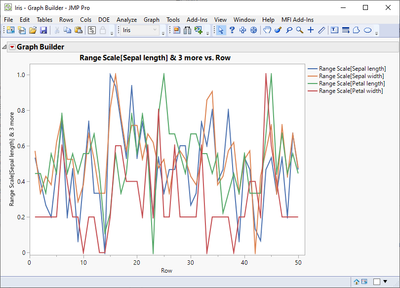

You can kind of do this with your method of choice: scaling by range, standardization, normalization... (you will of course lose the information on the original values, but in graphs shape might be).
With Range 0 to 1 formula:

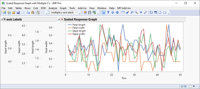

With the script from topic:

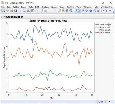

Without any transformations:
