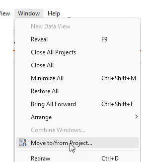

- tables can be moved into a project via

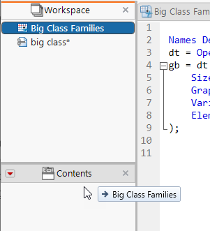

Besides USING a data table inside a project, you can also STORE the data table right in the project - just grab it in the Workspace area and drag it into the Content area:

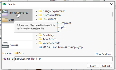

Another way to store the data table in the Project: click on the standard Save icon - but from within a project,
Then you will see a special menu where you can select the option to store the data table inside the project:
