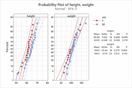

Example w/ data from Big class.jmp
Minitab: Automatic settings, 3 clicks in dialogue window

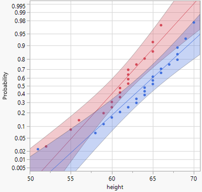

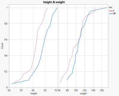

jmp (no JSL, just std. options)

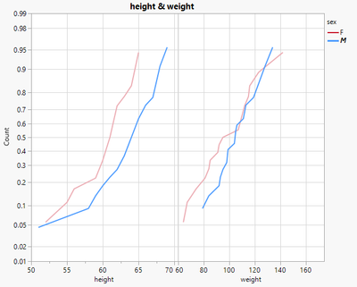

1. Graph Builder
Automatic settings
y-axis manually set to Probability Normal and adjusted to 0.01 and 0.99
2. Lifetime Distribution
Automatic settings. Nice graphics, but
- No panel option
- No info about distribution type (Normal, Weibull,...) and CI
- Legend missing when copied w/ "Copy Graph" (available in original report)

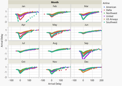

Minitab as reference - this is how the plot should look like:

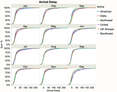

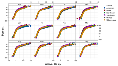

JMP / Graph Builder via Cumulative Percent "trick":
pro: months are in the right order
con: woah! completely wrong plot!!!
Under the line:
cumulative percent
IS NOT
cumulative probability

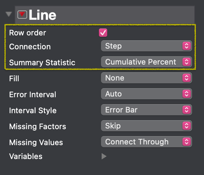

Hi everyone, thank you for the discussion and feedback! We are still looking into adding this in a future release, but our developers are currently focused on other features and functionality improvements in JMP 19, including other wish list requests. In the meantime, you can achieve similar results using Platform Presets (see steps below), however we understand this will not be sufficient in all cases.
Steps: Put a numeric variable on the X-Axis, select the line element, then change the settings in the line panel to what is shown in the image. Then make any other changes you see fit, save as a preset, and the next time you open graph builder, add a numeric variable to the X and select the preset you created.

I've seen various discussions related to this topic, and I've likely have missed some nuance, but I don't readily see any mention of using Cumulative Percent without a Y. Cumulative Percent will calculate cusum(y)/sum(y). CDF wants cumulative_count(x)/count(x). You can turn the former into the latter by replacing y with count, which can be achieved either by leaving out Y completely or replacing it with a freq variable (possibly all ones). Here's an example of the first way.
NB this computation matches CDF plots, but the Cumulative Probability transform matches the Normal Quantile plot and is slightly different.
Open( "$SAMPLE_DATA/Airline Delays.jmp" );
Graph Builder(
	Size( 650, 597 ),
	Show Control Panel( 0 ),
	Variables(
		X( :Arrival Delay ),
		Wrap( :Month, Show Title( 0 ) ),
		Overlay( :Airline )
	Elements( Line( X, Legend( 7 ), Summary Statistic( "Cumulative Percent" ) ) ),
	SendToReport(
		Dispatch( {}, "Arrival Delay", ScaleBox,
			{Min( -40 ), Max( 240 ), Inc( 50 )}
		Dispatch( {}, "", ScaleBox,
			{Min( 0 ), Max( 1 ), Inc( 0.25 ), Minor Ticks( 0 )}
