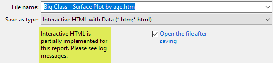

When you publish a report to JMP Live or export it to interactive HTML, most features are interactive. If your report contains features that are not supported and will be static, you get a notification during the publishing process.
Notification of Partially Implemented HTML FeaturesNotification of Partially Implemented HTML Features

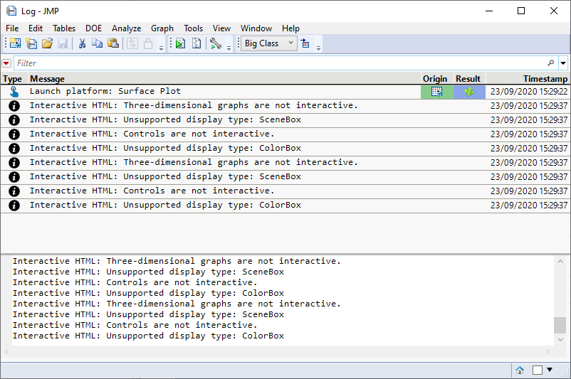

To find out which features are not supported, open the JMP Log. Select View > Log.
JMP LogJMP Log
