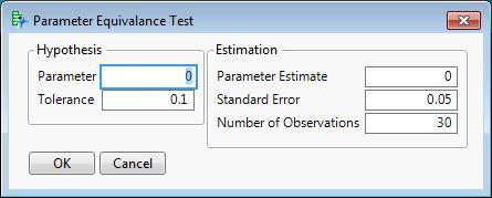

Here is what the initial dialog looks like when you run the script:
The script requires just five inputs:
  • The hypothesized parameter value
  • The tolerence value - any observed difference from the hypothesized value that is smaller than the tolerance indicates practical equivalence or similarity
  • The parameter estimate
  • The standard error of the estimate
  • The sample size - number of observations used for the estimate

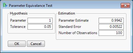

The parameter estimate is 0.9942, the standard error of the estimate is 0.00522, and the number of observations is 100. The values in the dialog are changed to match the situation:

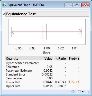

This result appears when I click OK:
The plot shows the hypothesized parameter and the interval of practical equivalence with vertical, black lines. The parameter estiamte is shown with a vertical, red line. The red arrows show the lower and upper differences between the parameter estimate and the lower and upper bounds, respectively. The information below the plot records the values input to the dialog and reports the lower and upper differences, t-ratios, and one-sided p-values. Both tests are signficant at α = 0.05, so we conclude that estimated slope is equivalent to the hypothesized slope.

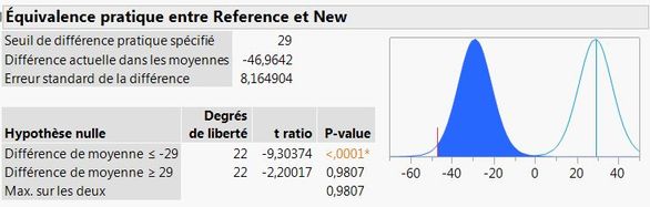

Is there a difference of using the script described above and the Equivalence Test (TOST) under Menu Analysis > Adjust Y by X (refer to screenshot attached)?
Thank you,
Thomas
Both tests are based on two one-sided t-tests. The test in the Oneway platform is to test equivalence of sample means. The script above is to test equivalence of parameter estimates.
