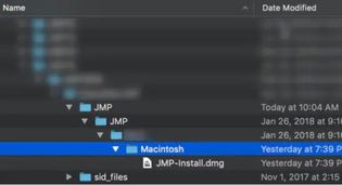

a. In the Downloads folder, browse to the /JMP/JMP/<version>/Macintosh directory and double‐click the installer. I.E. jmppro__<version>__mac.dmg or jmp__<version>__mac.dmg file.

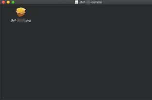

b. Double‐click the JMP version.pkg file to launch the JMP installer.

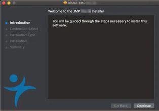

c. Click Continue on the Welcome to the JMP <version> Installer screen.

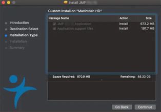

d. Click Continue.
e. Click Install.

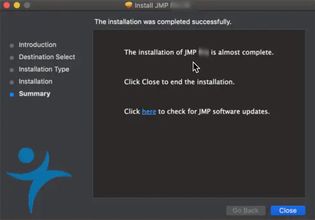

g. Wait for the installation to complete.
h. Click Close.
