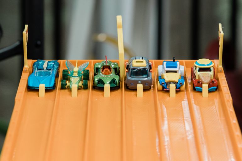

We have 10 cars and a 6-track course. How do we design an experiment to figure out which car is fastest? (Photo by Caroll Co)We have 10 cars and a 6-track course. How do we design an experiment to figure out which car is fastest? (Photo by Caroll Co)

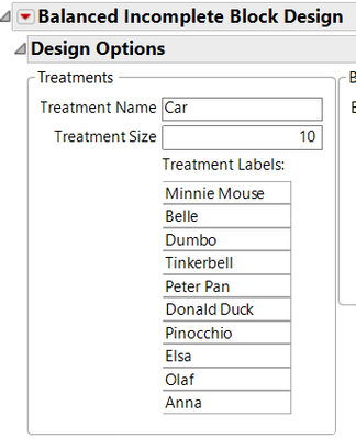

Our “Treatment” here is the car, so I change the name to “Car” and enter the 10 different cars we’re using:

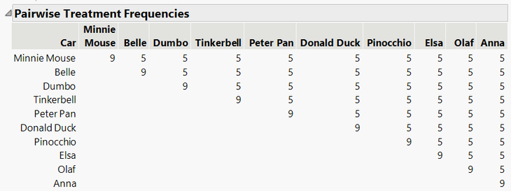

The “Pairwise Treatment Frequencies” indicate that each car will be used 9 times, and will appear in a race against each other car 5 times:

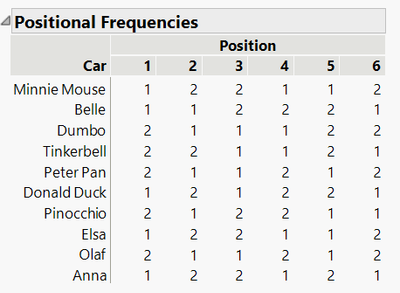

Many of the designs in the BIBD platform have been optimized for the positional frequencies. In this case, the position would reflect the lane number, so we do want to ensure that these are as balanced as possible. We cannot achieve perfect balance, since each car appears 9 times (which is not divisible by 6), but the positional frequencies are as balanced as possible, which is what we want:
