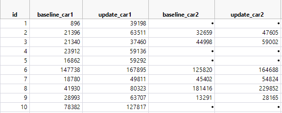

The first few rows and columns of the car mileage data set are shown below. These data were collected from a study in which 13,488 customers of a particular auto insurance agency were asked to report their current odometer readings. The readings reported by the customers are included in the data as the update_car1 to update_car4 columns, as each customer reported information for up to four cars. The data also contain the odometer readings for each vehicle when the insurance policies were first issued. These columns are named baseline_car1 to baseline_car4. Since all policies were not issued at the same time, the time elapsed from the baseline to the update varies for the observations in this study.

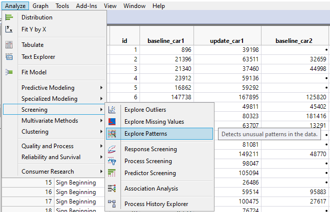

The researchers at Data Colada investigated rounding by looking at the last three digits of the mileages. We could use JSL to take a similar approach, but instead let’s use Explore Patterns! If you’ve never used Explore Patterns before, you can find it by selecting Analyze > Screening.
