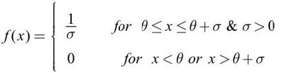

In general, probability distributions are mathematical models, or equations, used to describe and quantify the degree of uncertainty that we observe in our data. Under a continuous uniform probability model, the likelihood of observing a value x in the interval [θ,θ + σ] is constant and equal to, 1/σ or 1 divided by length of the interval. The mathematical equation describing a continuous uniform (rectangular) probability density function is

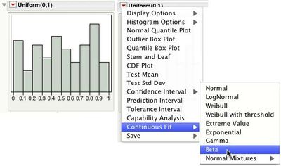

Let’s explore this relationship. The histogram in Figure 1 shows 100 simulated observations from a Uniform distribution in the interval (0,1). These observations were generated using the Random Uniform generator in the Formula Editor.
As expected, this distribution has a somewhat rectangular shape. To fit a Uniform distribution to this data, select Continuous Fit > Beta from the contextual menu (red triangle) on the histogram Uniform(0, 1) title bar.
Figure 1. Histogram and Continuous Fit > Beta CommandFigure 1. Histogram and Continuous Fit > Beta Command

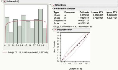

Figure 2 shows the histogram with the superimposed Beta fit, which has a rectangular shape. The fitted Beta Parameters Estimates show α=1.07 and β=1.03 (close to 1 — but how close?). The 95% confidence intervals for α and β both include 1, indicating that there is not enough evidence to say that they are different from 1. In practical terms, that means α and β are assumed to be 1 so the Uniform distribution does a good job at describing this data. The threshold parameter, θ, is 0.009 and scale parameter, σ, is 0.977 supporting a Uniform(0, 1). (Note that θ and σ are not maximum likelihood estimates. JMP sets θ to the minimum data value, and σ to the range (=maximum-minimum) of the data). Finally the Diagnostic Plot shows the points hovering closely around the line, and within the 95% confidence bands.
Figure 2.  Beta Fit to Uniform(0, 1) DataFigure 2. Beta Fit to Uniform(0, 1) Data

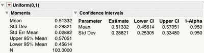

For a Uniform(θ, θ + σ), the mean is equal to θ + σ/2 and the standard deviation is equal to σ/√12 . The Moments table in Figure 3 shows the mean to be close to 0.5 and the standard deviation to be close to 1/√12 = 0.2886. Both the 95% confidence intervals for the mean and standard deviation contain 0.5 and 0.2886, respectively.

  6. Select Confidence Intervals > .95 from the red triangle menu on the Histogram to see 95% confidence intervals for the mean and standard deviation (see Figure 3).
  7. Check that θ + σ/2 (mean) and σ/√12 ( Dev.) are within the intervals.

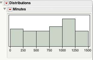

Figure 4 shows the histogram of the number of minutes since midnight for each birth occurring that day. It is reasonable to believe that in a 24-hour period a birth can occur at any minute, and the histogram seems to support that. Will a Uniform distribution fit the data well?

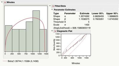

Figure 4. Number of Minutes Since Midnight for Each BirthFigure 4. Number of Minutes Since Midnight for Each BirthFigure 5 shows the results for the Beta fit. The Parameter Estimates, α=1.357 and β=1.154, are in the vicinity of one, and their 95% confidence intervals contain 1. The Diagnostic Plot looks reasonably straight. The Threshold = 5 and the Scale =1430, suggests that a Uniform(5, 1435) distribution describes the data. In other words, the probability of being born on December 18,1997, in any given minute in a 24-hour interval, at the Mater Mothers' Hospital in Brisbane, Australia is 1/1430 = 0.0007 or 0.07%.
Figure 5. Best Fit for Brisbane's Babies BirthsFigure 5. Best Fit for Brisbane's Babies Births

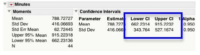

Figure 6 shows the moments and 95% confidence intervals for the mean and standard deviation. For a Uniform(5, 1435) the mean should be close to 5 + 1430/2 = 720, and standard deviation close to 1450/√12 = 412.8054. The 95% confidence interval for the mean does contain 720, and the one for the standard deviation contains 412.8054.
Figure 6. Moments and Confidence Intervals for Beta FitFigure 6. Moments and Confidence Intervals for Beta Fit
