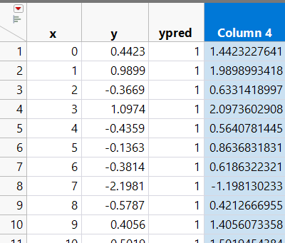

Now when we click OK and look at the result in the data table, we have
Figure 4:  Results of using a parameter in a formulaFigure 4: Results of using a parameter in a formula
So the formula now recognizes the current value of the a0 parameter and applies it accordingly. This important concept will be used in the next blog post when we use the JMP Nonlinear Platform to solve for the unknown parameters.

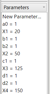

In Part 2 of this blog series, we developed the five simple polynomials to apply between breakpoints in the example data series. These polynomials had six unknown parameters: a0, b1, b2, c1, d1, and d2. We also had four cutpoints defining the regions where the polynomials were active: X1, X2, X3, and X4. We need to add each of these parameters to our Formula parameter list, along with reasonable starting values. When finished, the parameter list looks like this:
Figure 5:  All ten parameters entered and initialized for our piecewise exampleFigure 5: All ten parameters entered and initialized for our piecewise example
Note that I assumed starting values of "1" for each of the coefficients in the polynomials. For the breakpoints X1 through X4, I chose to estimate values based on "eyeballing" where I thought they might occur. This simply gives JMP a better place to start looking for the breakpoints.

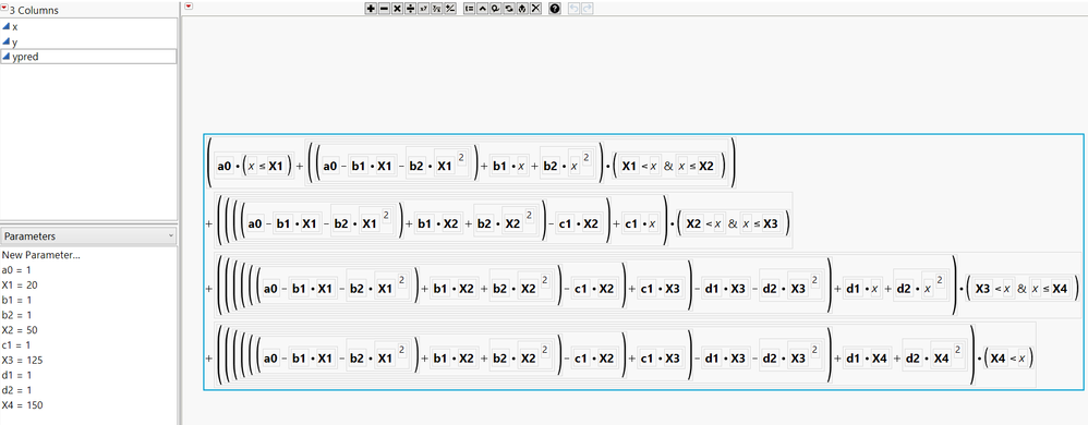

If we do all of that, we end up with a formula that looks like this:
Figure 6:  Complete piecewise formula (shown in Formula Editor mode)Figure 6: Complete piecewise formula (shown in Formula Editor mode)

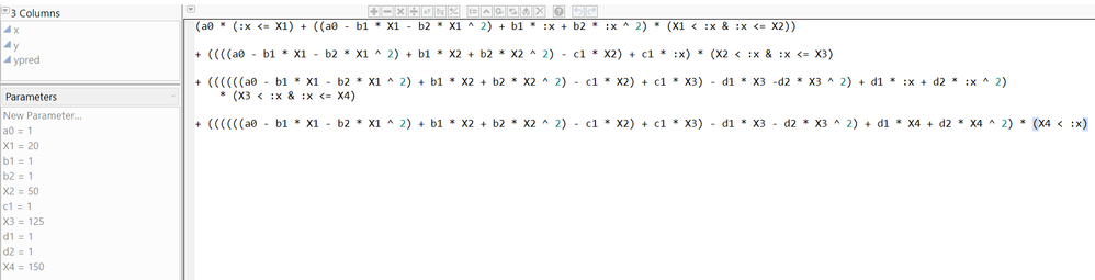

And below is the same information in JSL input format, should you prefer:
Figure 7:  Complete piecewise formula (shown in JSL mode)Figure 7: Complete piecewise formula (shown in JSL mode)
So to summarize, in Figures 6 and 7, we essentially have built a formula in a new column (called ypred) that:
  • Defines 10 unknown Parameters (and given each parameter an appropriate starting value) which will be used in the formula.
  • Describes four piecewise equations, each using their appropriate parameters.
  • Activates each piecewise equation by multiplying by an appropriate Boolean inequality that describes the ranges for each equation.
  • Sums the four equations to give the final formula.
Pretty cool...
