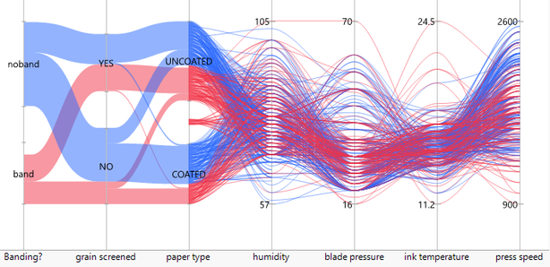

The biggest addition to Graph Builder in JMP 13 is a new element for parallel coordinates plots. JMP has long supported parallel coordinates plots as a separate platform, and integration into Graph Builder both expands the functionality and leverages core Graph Builder features like legends and grouping.
Categorical and continuous variables graphed with parallel coordinatesCategorical and continuous variables graphed with parallel coordinates

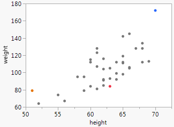

A parallel coordinates plot is an efficient way to visualize high dimensional data; however, it’s one of those chart types that requires a little explanation. For me, the first step in understanding parallel coordinates is to characterize “normal” graphs as using perpendicular coordinates. For comparison, here is the same two-variable data set shown using perpendicular coordinates and parallel coordinates.
 Perpendicular weight and heightPerpendicular weight and height    Parallel weight and heightParallel weight and height
In perpendicular coordinates, each observation is represented by a point at a two-dimensional location; in parallel coordinates, each observation is represented by a line connecting two (or more) one-dimensional locations. I colored three observations in the above plots to help show the correspondence. The orange observation, for instance, is at weight=80 and height=51 in both graphs. For only two variables, perpendicular coordinates are far better, but this simple example helps to illustrate how the variables are encoded in the chart.

Categorical variables
Categorical variables can be mixed with continuous variables, as shown in the first image of this post. When two categorical variables are next to each other, they are connected with a band whose width is proportional to the number of items. With some data sets, you can use this feature to get a Sankey-type chart.

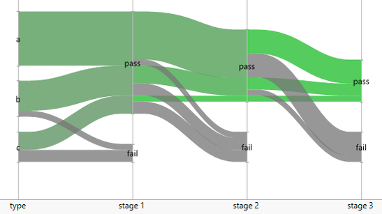

Using parallel coordinates to visualize a flowUsing parallel coordinates to visualize a flow

But I have a question on visualisation, how do you interpret the last graph? Seems like putting a percentage number on how many type-a patients pass different stages is more meaningful. Can't seems to see any patterns in the graph other than more failures at later stage and type-c.
XanGregg
Staff
Thanks for the comment and question. Maybe I should have planted a stronger pattern in the last graphic to make its case better. As a visual (without the numbers) it lets you see any really unusual changes in sizes or colors, which will be more meaningful if you're comparing lots of similar such charts. And because the groups split as you go across, you can follow groups as they "flow" through the stages. Group "a" fails very little in stage 1 or stage 2, but fails at a high rate in stage 3. Group "c" has a lot of failures in stages 1 and 2 but none in stage 3.

Very nice graphs. I already use parallel plots through the Mutlivariate platform, in order to find specific profiles between items in psychometric scales. But I really don't know how to obtain those Sankey plots. Could you please give us an example (data and syntax)?
XanGregg
Staff
Thanks, @yvesa_roy. I attached flow1.jmp which contains a script for the Sankey-type chart. The trick is to take advantage of the was the parallel coordinates element draw filled bands instead of lines for categorical variables. In the example, type, stage 1, stage 2, and stage 3 are all categorical variables.

And thank you very much @XanGregg, indeed. I found my mistake: instead of typing multiple lines per condition (a, pass, pass...), I tried to simplify the data set by typing only one line per combination and adding a variable with the frequency role. Bad idea!

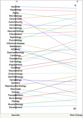

Is there a way to change the axis on a continuous variable? For example, I'm plotting the change in rank of 34 medical specialties. The first variable (Specialty) is categorical and ordered. The second (Rank Change) is a continous variable that can take values from 1 to 34. Oddly, JMP displays a range of 0 to 35, which distorts the shape of the plot. Is there a way to change the right axis so that the plot displays properly?

XanGregg
Staff
You can customize the min/max values by setting an axis property on the column (which is also the belated answer to @pmd8's question). For the fonts, use the Fonts panel in Preferences.
