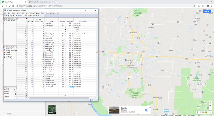

Seems straightforward enough, right? The first step was to compile a database of highway intersections, showing which highways connected to which other highways and the locations of these intersections. I spent a great deal of time trying to find such a database ready-made, but no such luck. So I decided to make my own in a data table.
Example of the process I used to get the coordinates for each intersection. A true labor of love.Example of the process I used to get the coordinates for each intersection. A true labor of love.
It’s worth mentioning that often times highways will intersect one another multiple times or even run concurrent with one another. I only recorded the first intersection that occurred when following a highway from north or east to south or west, imbuing my network with an inherent directional bias. In fact, that’s exactly what I was building: a network of US Highway “nodes” based on their intersection “edges.” Once this network was complete, the goal would then be to find a path through the network that connected each node with no node being repeated in the path (if possible).
