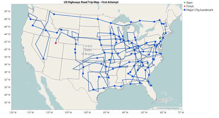

After carefully putting these constraints into my algorithm, I decided to start the path with Hwy 46 and run the algorithm. There were a few highways left out, so I used Method 1 of the Filling the Gap methods to fit them back in (the “graft and retry” approach). After three retries …success!! Figure 1 shows the raw output of this first attempt.
Figure 1: Raw output of first attemptFigure 1: Raw output of first attemptThis was a bit too clunky for my taste, so I went in and, with some friendly assistance from Google Maps, filled in some of the lines with extra points to add a bit more curvature and follow the actual route more closely. I also added in a Marker Type column to my data, which I could use to identify major cities and landmarks along my path. To keep from crowding the graph with too many markers, I copied the Latitude column, deleted the values in that column that were not associated with a major city or landmark, and then made the points use that column as its “Y-axis” (you can do this by selecting the Variables arrow under the appropriate group in JMP Graph Builder). By the way, the background maps I’m using here are Street Map view with the US states imposed (the border lines are set to a slightly darker grey than the default).
After this bit of tidying up, I get the path shown in Figure 2.
Figure 2: Cleaned version of first attemptFigure 2: Cleaned version of first attempt
I can imagine some of your responses to this map being among the following:
  • Gaaaahhhh!! What is that?! It’s hideous!! It looks like someone gave a 2-year-old a fine tip marker and a map of the USA on which to draw.
  • So I can just make out where you start and where you end, but how on earth do you get there? I thought the Spaghetti Intersection in Atlanta, GA, was bad….
  • Hey, you completely missed my state!! (from residents of California, Arizona, Rhode Island and Maine).
  • What’s with the trip through Canada? (This one’s easy. Fun fact: Hwy 2 is split into an eastern and western portion by design! To traverse all of it, a detour into Canada is required. No complaints here!).

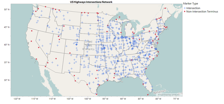

Figure 3 shows the highway network I compiled as described in the previous post.
Figure 3: The highway intersection network visualizedFigure 3: The highway intersection network visualized
 From this figure, we can clearly see why those states were missed.
  • There are no intersections in California, only ends or beginnings (there’s a profound statement there somewhere).
  • There is only one intersection in Maine, which happens to be between Hwys 1 and 2 in Houlton. This intersection could have easily been passed over in the path search.
  • There are only two intersections in Arizona; Hwys 60 and 95 (left) and Hwys 60 and 70 (right). Same reasoning as the previous point.
  • There is only one intersection in Rhode Island: Hwys 6 and 44.

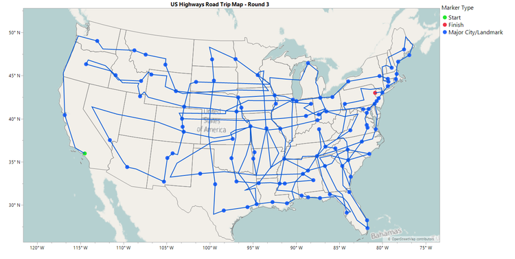

With these new constraints added, I re-ran the algorithm and had only one highway left out. So I used Method 2 of the Fill the Gap methods to add it back in (the “try every option” method). After some cleaning, this resulted in the map shown in Figure 4.
Figure 4: The second attempt at a road tripFigure 4: The second attempt at a road tripWell, at least every state has some coverage now, though it is still a bit messy. One thing I still wasn’t too keen on with this trip is the loop there in Wyoming. It turns out that Hwys 87 and 85 run pretty much concurrently with I-25 from Denver down, which is why they show up the way they do here. Also, it looks like Washington state gets hardly any coverage, as does Vermont. So I added a few more constraints (including switching to a Hwy 101 – Hwy 12 start) and got the path shown in Figure 5.
Figure 5: Yet another attempt at a road tripFigure 5: Yet another attempt at a road tripLooking a bit better now. Still a lot of overlapping with some parts of the path, but not as bad as the round 2 version, in my opinion.
