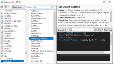

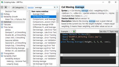

This example demonstrates a different way of using the Scripting Index. I searched for "average," but there are no good matches in the item list. (I should have searched for "mean.") I do notice, however, that Col Moving Average allows me to calculate moving average over groups and that it belongs to the Statistical category. In some cases, that is exactly what I'm looking for; I just need to find the most probable correct Category.
Next, I remove the "average" search term. The item list now shows me ALL items in the Statistical category, while remaining on the item I selected earlier (Col Moving Average).
Looking through this new item list, I notice that there is Col Mean, which is exactly what I want.
This isn't the only way of calculating average over groups. If this isn't what I'm looking for, at least I now have a new search term: "mean" instead of "average." You could also use Summary (Data Table category) or Summarize (also under Statistical), which means you could reset your search using this new term. Search for "mean" -> "Col Mean" -> Statistical category -> filter to statistical category -> have statistical category filtered by mean:
